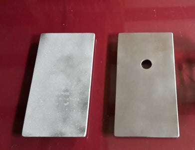

Now the metal part is behind us. We can bring out the drill and start the cleanup. Take you time. It would be a shame that all your soldering is ruined by poor cleaning
I have unfortunately no pictures of the drill action .They have become lost somewhere in the upload process of my camera
In the pictures you see the last cleanup by hand . Also sand the plate whit sandpaper. Start whit the rough grain and work you way up to grit 600
the last cleanup is done using steel wool

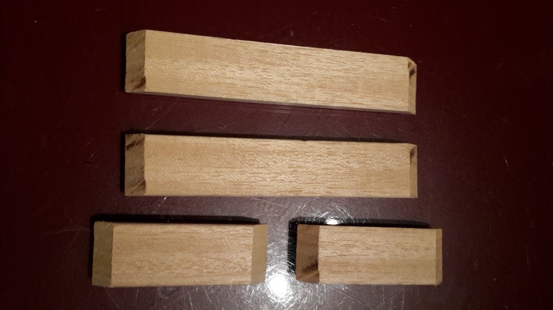

I took the piece of wood. And sawed pieces that were just slightly longer than the sides of the plate. Each corner is in an angle of 90 °
therefore, each piece has an angle of 45 °
make sure your wood frame is higher than the height of the candle

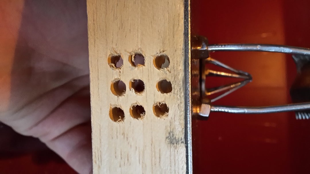

One staple in each corner together whit some glue and presto a base is born. On the backside I drilled holes that act ass a air intakes.(I went for the artistic crooked freehand hole look)
you can now glue the base to the metal part whit some heat resistant glue.

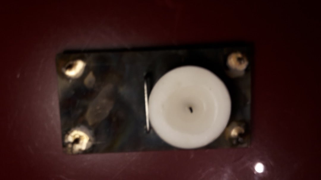

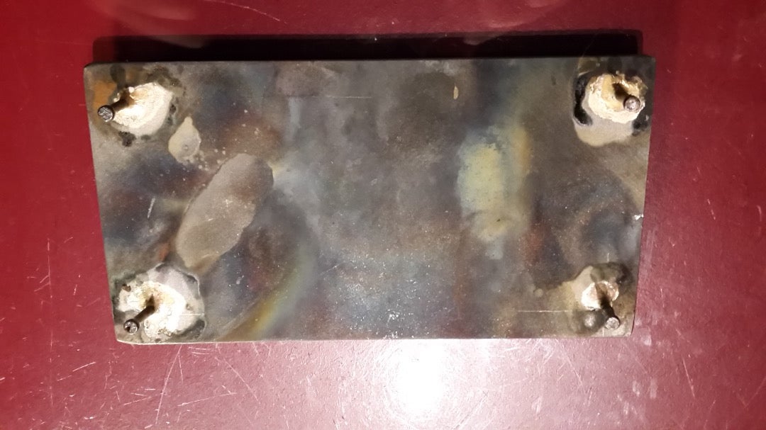

Take once your torch and solder four nails slightly lower then the height of the wood in each corner of your base plate. To determine where they should take a piece of wood (you just used to make the box) to know the thickness The picture says it all. Solder the nails in place.and then bend the nails slightly outwards so that the Indian construction fits on
Also you can see that I have made support points for the candle made of two nails. This is optional. But now you're at with soldering you can do this quickly. This piece I not visible so the need for sanding is not present

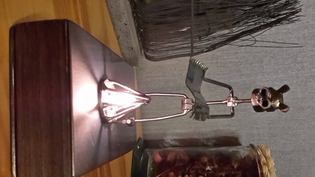

And there you have it . A funny little Indian that waves his shiny carpet above some real flames/insence
Stop , step back and admire the fruit of you're new acquired soldering skills. You can use incent pyramid as well.
