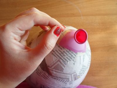

When you are sure that the base of your lamp is dry, pop the balloon with a pin and remove it.
Now that you have your hard base, cut about 2/3 of it (maybe a little less) and throw the remaining part away.

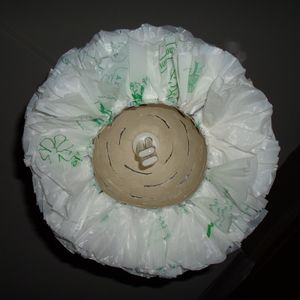

It's time to put all pieces together! So prepare your paper base and your pieces of plastic.
Take one piece of plastic, bend the end (the part that you closed with the stapler) and stick it to the bottom of the base, using a small piece of double-sided tape.
Continue this way with other pieces of plastic, sticking them one next to the other until you cover the whole bottom. Proceed this way covering the rest of the base.
Remember not to cover the cuts your made previously with tape. Use them as guiding lines.
Step 8:
You will probably need to make more plastic "fans" before you finish...
It took me a whole afternoon to do it but I can't express the satisfaction I felt looking at the result! I am very proud of it.
I recommend using LEDs or at least an energy saving bulb because regular light bulbs get too hot and might burn the lamp. Remember that it's made with paper and plastic so be careful! If you use LEDs there won't be any problem.
