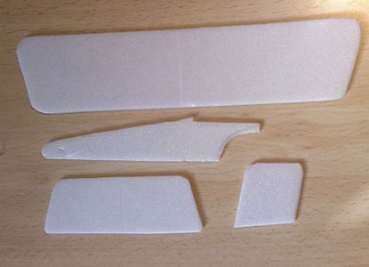

First print the plans on an A4 sheet, and cut out the wings and cockpit.
Don't mind the fuselage stick, that is not important now, you don't need to do anything with it at this moment. Place the cut templates on the pvc-foam, and draw exactly outlines.
Cockpit: Here I made a small change: while I didn't want to shoot the plane with a rubber band, I left over the groove from the cockpit, to make the whole fuselage stronger; you can see the strenghtened arch of it on my pics. Of course, you can copy and cut it unchanged, so then wou will be able to sling it, but in this case you must build the model from cardboard. The foam cockpit variant is for only a ligthweight glider version.
Wings: After the copying, cut the elements with a sharp cutter. Don't use scissors, it causes deformed edges on the wings.
After you cut the main wing piece (including both of the wings), find its geometrical center, and, as seen on my picture, press a ruler on that line, exactly. Now you halved the wings into a right and a left wing piece, and now you can fold them a bit. DON'T fold it more than some degrees; when you will assemble this part to the fuselage, that's enough to bend them a little.
Fuselage and wing support: And now see again the plans, and find the fuselage stick; this is a simple 3x3 mm balsa stick with 18 cms lenght. Cut it from the whole stick, and cut one 2,5 cm long piece, and two 5-5 cm long pieces for the wing support, too. And finally cut a 2,5x5 cm rectangle from the foam sheet - these are the parts of the wing support.

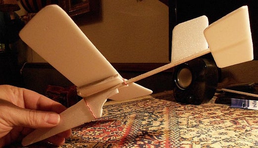

When ready, take the balsa stick (18 cms), and glue it firmly to the "BODA" cockpit part. Line the parts well, and do it exactly. Then glue the vertical tail piece onto the other side of the fuselage stick, (see on the plans, where) and place the model on a flat surface, while the glue dries. The cockpit and the vertical tail piece must be in the same level.
Now build the wing support together: you've cut a 2,5x5 rectangle before, and the three short balsa pieces. Using the double sided adhesive tape, assemble them exactly as seen on the pics: the 2 long pieces go onto the 5 cm edges on the upper side, the short piece goes onto the one of the 2,5 cm edge from the OTHER side. (See this on the auxiliary plans I made.) When ready, glue this support on the cockpit, exactly the given place, at the head of the balsa stick. Everything must be symmetric, and the 2,5 cms stick under the support must be glued toward the nose of the model, as seen on the photos! Other words: that small stick must lift the leading edge (the edge to forward) of the wing!

To attach the wings pull the rubber band on the fuselage, press the wings on the support piece, and pulling the rubber band carefully toward the nose, moving under it, and release. This procedure will fix the wings, gives a small pressure as necessary on the middle line of the bent halfwings to keep them is "V"-shape, but lets some room for the motion of the wings at an unwanted impact.

Well, now you can admire on your work, but it can't fly yet, because it isn't balanced. To do this, get some adhesive foam spots (people use them to stop the slipping of their chairs on the floor), or anything else, that you can cut, and glue, and light enough for this procedure. I like this anti-slippers, these are well useable and well cuttable.
Now take your model, and place the root of its wings onto your fingers at the point I marked with a red spot on the plans. Now try to glue small foam spots symmetrically on the two sides of the nose, to reach that stable state, when the model is balanced on your fingers. I had to use 6 pieces, you will more or lesser - must be tried. Do it exactly and symmetrically as I have mentioned before. To see the proper angles and positions, refer the explanation drawing here.
And now you are ready to try the model: find a good place indoor (at least first!), and push the model on the air, not upwards, but a bit downwards, almost horizontally, slowly and carefully.
- If it is glidingsmoothly, with a small sinking, you are ready. It must fly even 20-30 meters, if the circumstances are lucky and optimal.
- If it is sinkingrapidly, decrease the nose weights, if it is nodding, climbing and sinking periodically, increase the weights.
- If the model is falling in a "corkscrew", or turning around more than some degrees, you have built it non-symmetric, the wings and tail pieces are in bad position or are inclined, perhaps crooked. You must refer the view to the pic.
During the gliding the model must find the horizontal balance, when something tilts it, and it's a good result, if advances along a line, doesn't turn to right or left.
