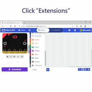

Step 3: Adding Servos Extension
Servos extension
Does your MakeCode editor include Servos extension? Please open the editor and check if it includes Servos extension in the left menu. We will use it in Receiver.hex sample file. This Servos extension will be used for calibrating the steering angle. If you can't find Servos extension, click Extensions in the bottom of the menu. Click Servos extension and add it to the menu.
