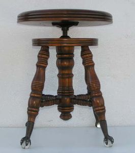

The form is kind of a knock-off of the claw-foot, wooden screw type of organ stools. It would also make a nice stool for a drummer, or considered a post-modern commentary on Marcel Duchamp's famous "readymade" mash-up of a stool and a bicycle wheel.

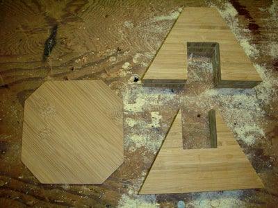

The core of the stool is made from some scraps of 3/4" bamboo plywood. I cut the shapes shown on a bandsaw, then laminated two of each together with urethane glue, which is good for non-porous surfaces. Bamboo plywood is very hard and very dense, which makes it difficult to work and glue, but exceptionally strong. Lacking access to bamboo plywood, just make the pieces out of regular plywood or a dense hardwood like oak. The pieces have a 37 degree angle to the sides, and are approximately 4" from top to bottom. The width at the top is 1-1/2", same as the width of each piece and each leg. The bottom plate is 1/4" bamboo plywood.
The legs were also cut on a bandsaw, at 15" long, tapering from 2-1/4" to 1-1/4" at the bottom. They are pine, from old 2x4 scrap.
Once the pieces are cut, slather them up with some more urethane glue and stick 'em together. Screw on the base plate to hold everything in place as the glue cures, or use big clamps. Make sure everything is square before you screw them together. Urethane glue (Gorilla Glue) need water to work properly, so dampen the wood first with a sponge. It also expands a tremendous amount as it cures, so either wipe it off as it comes out, or cut it away with a razor after.
