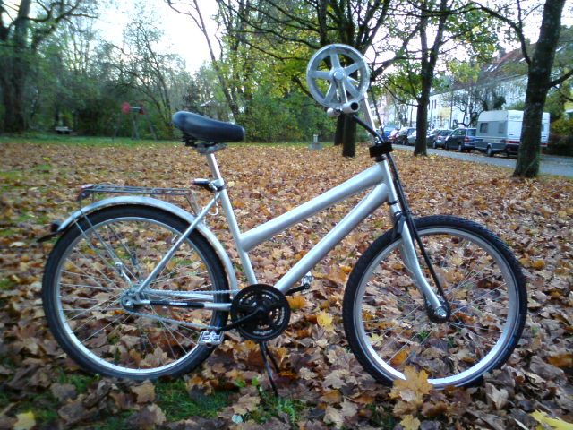

Why simultaneously pedalling? In my case It improves direction of my front wheel drive recumbent.

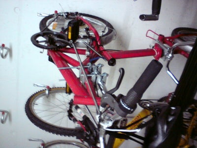

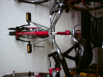

Step 1:
dismount one of the cranks and mount it parallel to the other one. You need a crank puller for that:
https://www.instructables.com/id/How-to-use-a-crank-puller/
Step 2:

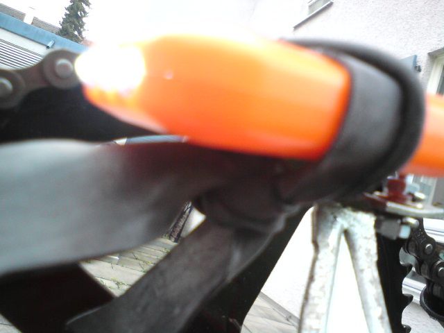

Attach springs to pull the crank up to the upper position. Is better with several springs in diferent angular positions, the movement will be smoother.
Of course you may use clipless pedals instead of springs, but be carefull, you risk to fall attached to the pedals if you are not used to them!
