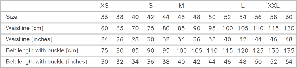

Now cut the exact length of the belt and mark the adjustment holes position, you can leave about one inch between them, or a bit less. To know the exact length measure your waistline and add about 15-18 cm (with the buckle length). If the belt is not for you, take note that a small waistline is about 60 cm (24")  for a girl and 75 cm (30") for a guy, and that belly can grow up to 120 cm (48").
Look the following table to determine the right length, then punch out the center hole at the waistline distance from the end of the buckle, and add two or more holes at each side of the first one.
