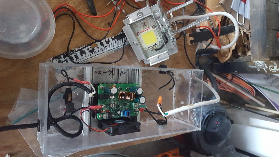

This is the demonstration of powering 100W/34V LED from 12V power-supply .
there are 5 parts
1, 12V/7.4Ah UPS sealed lead acid battery
2, DC-DC step up converter [12v to 34V boost converter ]
http://www.ebay.com
3, constant current driver [ not include ]
low cost LED driver from http://homemadecircuitsandschematics.blogspot.in
4, LED 100w /34V with sufficient heat sink [ Processor heat sink is a good option ]
http://www.ebay.com/sch/i.html?_sacat=0&_sop=15&_nkw=100w+led+bulb&_frs=1
5, LED Lens and Lens holder
