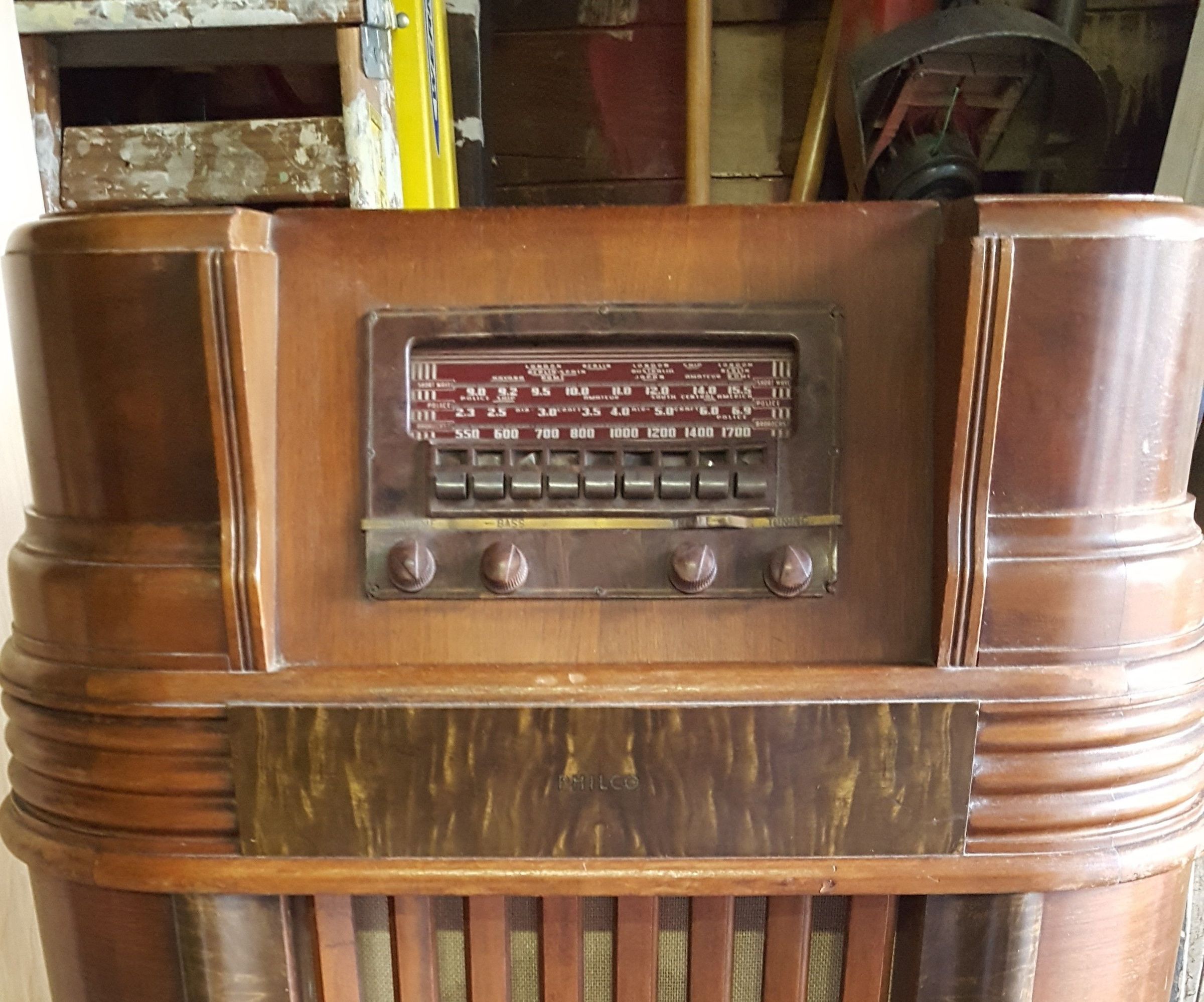

I picked this 1938 RCA model 811k on CL for under $100. To me, when buying these old radios for a conversion, the challenge is to get as much functional use out of them while maintaining the original look of a functional radio.
Step 1: Beginning the Conversion
As can be seen, this radio needed to be refinished but all the veneer was intact other than some splaying on the top left side. I removed the carriage and speaker and all of the knobs and plastic facing and put them all away for safe keeping. I sold the carriage and speaker on CL at a low price since their are only a finite number of them around. I knew this would lend itself to a conversion while keeping the art deco radio look mostly intact.

Step 8: Cleaning and Repairing the Radio's Escutcheon & Knobs
The first picture shows what it looked like on the original radio. Two labels were missing (which I later found in the radio) and the plastic was dirty. I took it all apart and shined the plastic parts with Novus compound to shine them up. The metal parts had a finish on them which did not lend them to being shined up with brass polish. I just cleaned them up and cleaned the glass with windex. This unit had a light on the top of the escutcheon which was part of the working carriage. I filled the hole with a piece of 1/4 ply stained and finished match the radio cabinet. After reinstalling it looked great.
