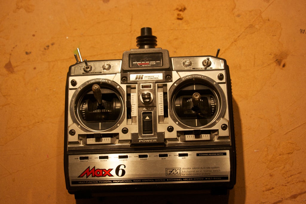

I purchased an old, 35MHz transmiiter with no cystals and no receiver from eBay for £16. I then opened it up and removed the old Transmitter board. I then wired the potentiometer for each control to 5V and GND, the last connection; the middle one, was connected to it's analogue pin on the arduino. If you want to incorporate more potenetiometers than 8 then you will have to use a bigger arduino or a multiplexer chip, which can get confusing.
The battery was connected to the VCC pin on the Arduino, 5V for the pots and XRF.
The code is here https://github.com/Streuli273/Arduino-XBee-Remote-Control
