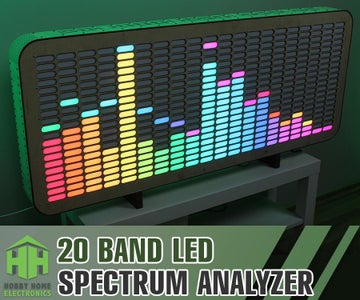

Intro: 20 Band LED Spectrum Analyzer
Good afternoon, dear viewers and readers! In today’s article I’ll show you a complete assembly manual for 20-band LED spectrum analyzer based on STM32 microcontroller and WS2812B addressable LEDs.
STEP 1: Circuit Design and PCB Layout
The schematic diagram and printed circuit boards (PCBs) of the 20-band LED spectrum analyzer were designed in the Easy EDA online environment.
On the schematic diagram of the spectrum analyzer, there are such nodes as: the STM32F407VET6 command microcontroller, a microphone amplifier on the MAX9814 circuit, an amplifier on the LM358 circuit, linear voltage regulator on the LM1117 circuit, a Piezo buzzer, an infrared receiver and control buttons.
Based on the schematic diagram, it was obtained a double-sided control PCB with SMD components located on it for surface mounting.

STEP 25: Work Result
After mounting the case, we proceed to a demonstration of the operation of 20-band LED spectrum analyzer.
The operation of a 20-band LED spectrum analyzer is best observed personally and in a darkened room, since it is not possible to fully convey the whole of color saturation through the camera lens.
