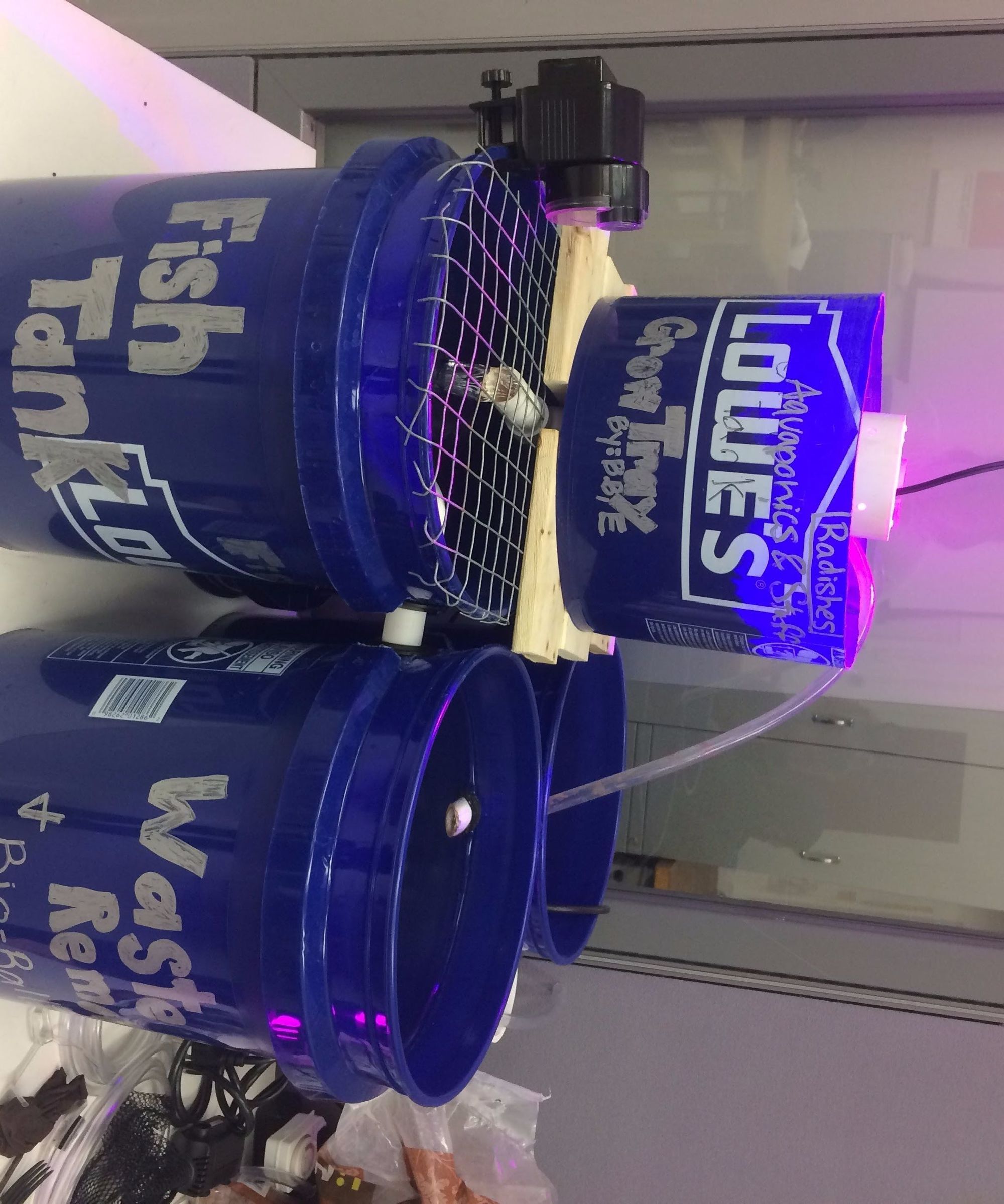

After getting our actual materials that we were working with our designed changed a little. We also decided to consolidate the mesh filter and bio balls so that we could have an empty bucket for adding chemicals and monitoring the water. Our final system had water flowing from an elevated grow tray held up by an upside-support bucket. the bottom 3 buckets would be for the fish, the filtration bucket, and the monitored bucket.

We cut the 5-gallon bucket 5.5 inches from the bottom all the way around. We then attached the Media filter pipe an inch and a half from the edge. The media pipe is there to prevent any of the grow media from getting into our bell siphon area. We did not glue the media pipe down, however, we should have as we encountered a few issues with media getting into the pipe as we got it all settled in. The media pipe had lots of holes drilled into it, to allow ample water flow, but it's important to make sure the holes you drill are smaller than the media that you place into the grow tray.
Step 8: Construct Bell Siphon
In order to create the bell siphon, we used a 3" pipe (black) and 1" pipe (white) to create the suction. In order to see the process in action, we created an acrylic covering, that also functioned as the seal in order to get the Bell Siphon to activate. There were multiple holes drilled into the bottom two inches of the bell siphon to allow water to pass through, as well as a single extremely small hole, in case the system failed, it will drain out so the plants will not drown. We originally ran into some siphoning issues, getting it to activate and to stop, so we 3D printed a small funnel-like piece, that decreased the hole's radius to just half an inch in order to create more pressure inside the pipe, allowing for easier flow.
Step 9: Adjust Bell Siphon for System
While constructing our Bell Siphon, and after dozens of tests, we noticed an issue that there was too much pressure, so the siphon wouldn't "break", or reset to clear the siphon and begin filling it up again. To combat this, we drilled a hole at the top and attached an air tight tube, and ran it along the base of the pipe to the hole line near the bottom. This allows for more opportunities for air to enter the system and "break" the siphon. We experimented with adding cuts on the sides, however this just added air into the siphon system, but not enough to break the siphon. It added enough air to slow it down, but not enough to stop it.

The major adjustment we had to make to our system was to add some type of cover to the fish tank part of our system to prevent the Tilapia from jumping out. We had one fish that insisted on trying to get out of the tank so we decided to put a wire cover over it and this was successful in preventing the fish from being able to get out.
Another minor adjustment was making sure the pipe that goes into the fish tank to fill it was tight so that it was not falling out and making sure there was something to filter the water coming out of the grow bed into the fish tank to prevent excess dirt particles from the growth medium from getting into the fish tank.
