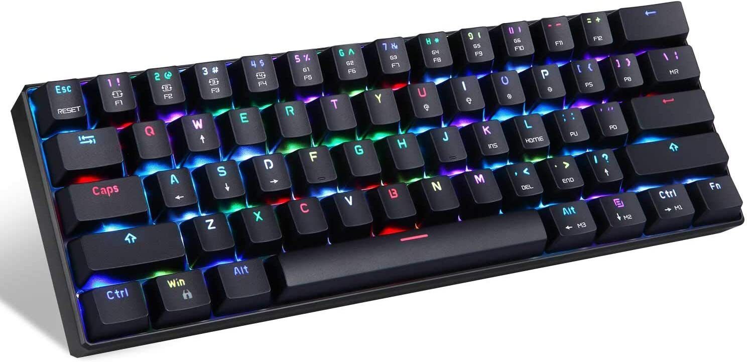

Step 3: Assemble the Keyboard
When I scaled down the keyboard frame and measured, I found that at most I had an area of 295 x 110 mm to fit the actual keyboard. Yikes! So I began my quest for the perfect keyboard for this project. Eventually I found the MOTOSPEED CK61.
At 290 x 100 mm, the CK61 just fit into my design. It was well reviewed and reasonably priced enough that I could afford to use it for this project. I ordered the version with the "Blue Switch" which I assumed were Cherry MX BLUE (or clones) and in fact turned out to be nice and "clicky". The more conventional staggered layout is definitely a better look for this reproduction. I knew that I would never find a keyboard with a number pad that would fit, so I feel that this keyboard is a reasonable choice.
The keyboard frame was printed in two pieces, glued together, and reinforced with the cross piece you can see in the left photo above. The cross piece also supports the CK61 at the proper height. On the right hand photo above the finished keyboard.

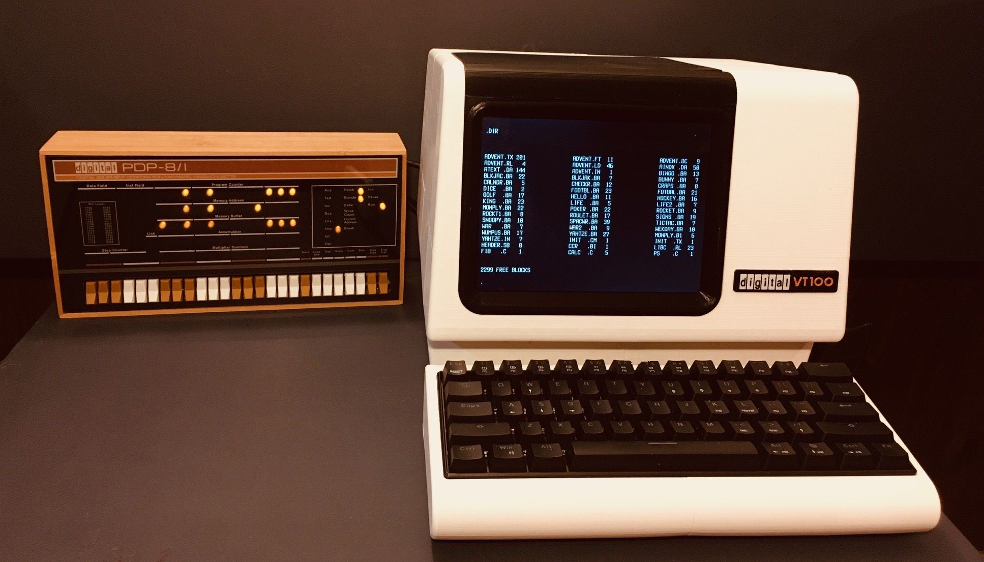

I was lucky enough to find the prefect LCD display for this project. The PIM372 (Digi-Key part number 1778-1225-ND), is an 8 inch 1024x768 XGA display. The optimal size for a 2:3 scaled down display is about 168 x 126 mm. Well the viewing area for this display is 165 x 124 mm. It doesn't get much better than that.
The Screen Frame has been designed to look like the original VT100 CRT frame on the front and hold the PIM372 securely on back.
I printed a carrier for the driver board (Display PCB Holder) and used two sided tape to hold the PCB in place. Then I attached the carrier with PCB to the back of the display (also with two sided tape). I mounted the display onto the frame with painters tape. Also note that I added a 90 degree HDMI “elbow “ so that the cable would go straight out the back.
Step 5: Attach to the PiDP-8/I
At this point you should have everything need to attach this reproduction to the PiPD-8/I. What we have so far is essentially just a 3D printed enclosure for the monitor and keyboard that will be connected to the Pi in the PiDP-8/I.
Snap the Screen Frame with display to the front of the Terminal. Run an HDMI cable from the VT100 display to the Raspberry Pi in the PiDP-8/I. Similarly attach the keyboard to the USB connector on the Pi. Add the Top Cover onto the Terminal and voila you have a PDP-8/I running OS/8 with a "terminal" connected.
I might have stopped there having accomplished my original goal, but I got it in my head that the scaled VT100 reproduction would make a pretty funky and unique mini arcade console. So read on.

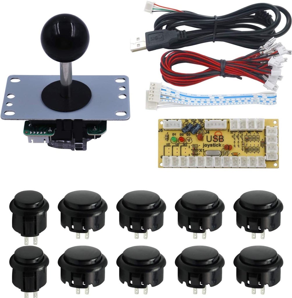

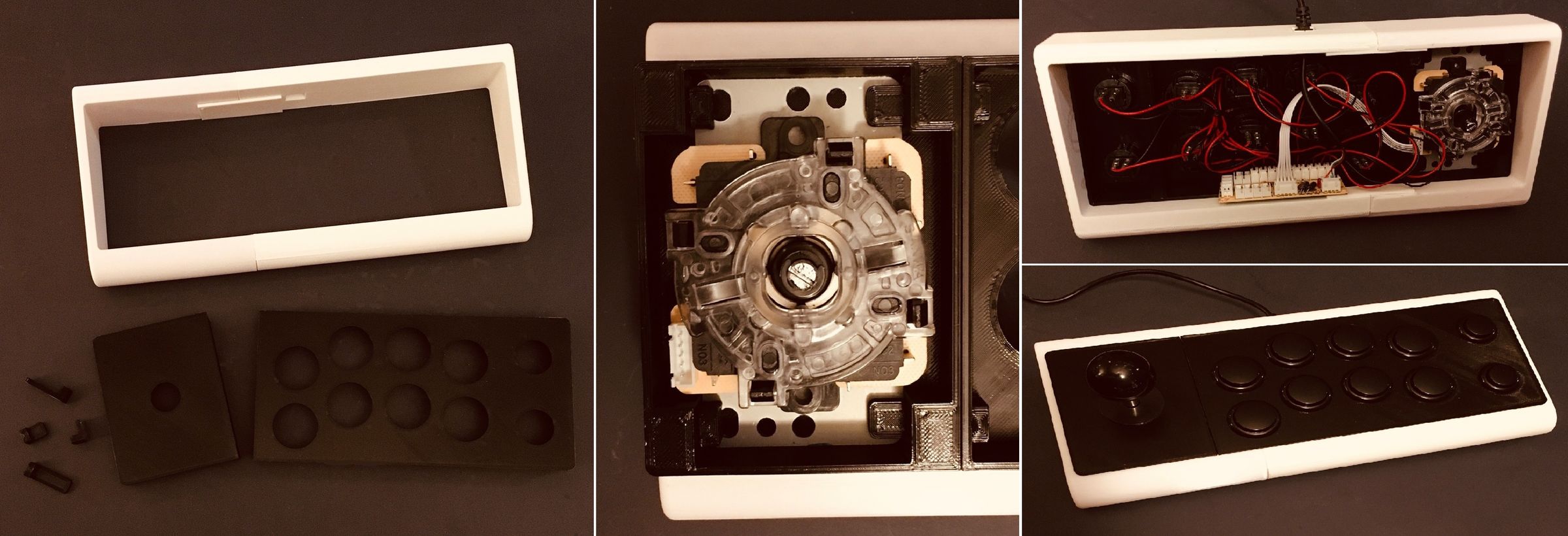

I purchased a DIY Arcade Kit with a USB Encoder.
I designed a new VT100 style keyboard frame along with a top plate to hold the controls in place.
The keyboard frame was printed in two pieces glued together with the help of some braces.
I mounted the joystick in a frame printed on the bottom of the top plate and held it in place with some printed "tabs". The longer tabs also join the two top plate pieces together. Wiring is pretty straight forward as the kit comes with a USB interface board and all the cables necessary to build a working arcade console. I mounted the USB board to the side of the keyboard frame with (you guessed it) two sided tape.
The top plate then slides into the keyboard frame.
