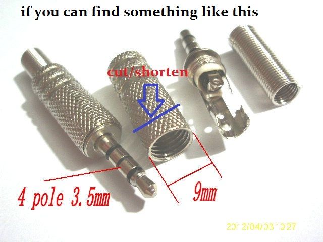

Step 1: The Making
Use this ^ Circuit Diagram to wire
You need:
• A frame - like the one i used to attach the sockets on
• Drill - to make holes
• Sockets (pictures ^ with circuit diagram)
• Soldering Iron
• Cables to connect
Time and patience xD
Step 2:
See this image, you see the frame i used (the round thing only). the wood isn't part of this project, that's my upcoming project, An LED lamp with rotation capability, it's under construction.
This adaptor is easy to build, all you need is drill/bore 3 holes on the frame and attach the sockets on and use fasteners
The sockets usually come with fasteners, i used that fasteners to fasten sockets on the frame
Step 3: Notes
• The 3.5 mm Socket leads must be connected in right way. Left, GND, Right, if you wrongly connect the leads, the audio will sound just not right, you can use Internet to find out leads order.
• Same goes with RCA sockets,
• you can also use a multimeter to find out leads level
