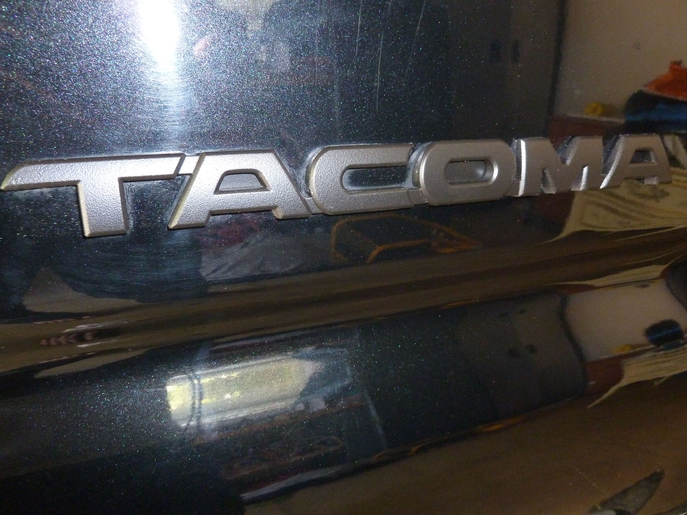

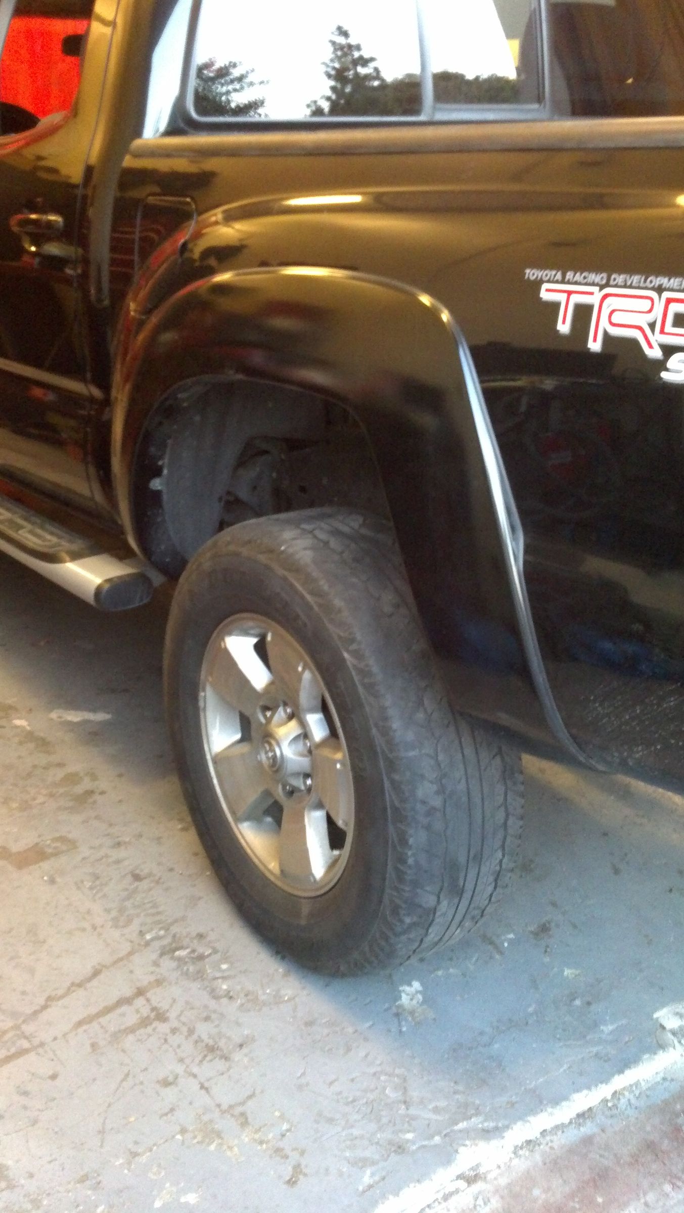

- I have used blue tape to the back of the part and leveled the part
- Add slurry till it slightly overflows
- Allow to dry/set - time varies
- Use sand paper to smooth - Start with 100 grit and go 200 grit for nice finish
