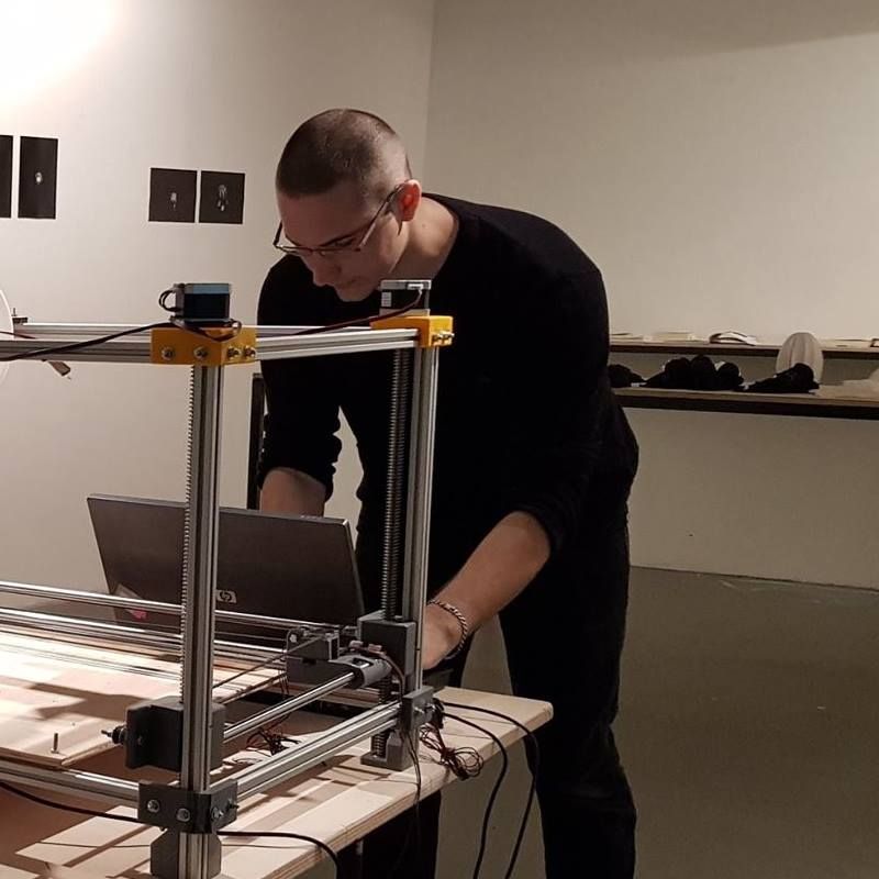

Step 3: Print the Draw on the Cloth
You must then prepare and export your file as for any other impression, there needs no special settings.
Take then your cloth, reach it to it's maximum on the tray of your printer, use tongs to it does not move.
Then start printing , plastic should come and stick to the cloth, if it don't try again, this time the print head closer of the 3D printer bed.
