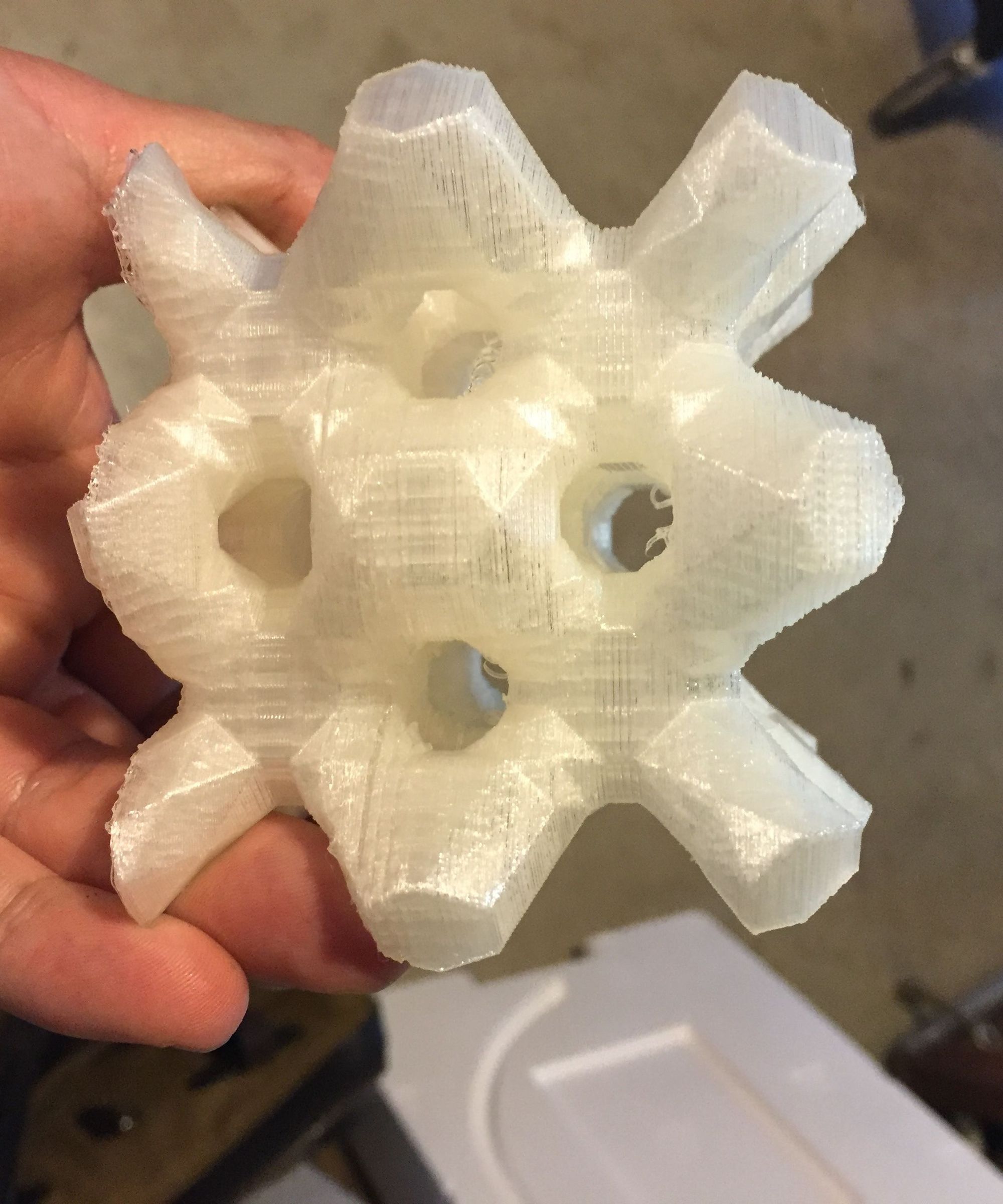

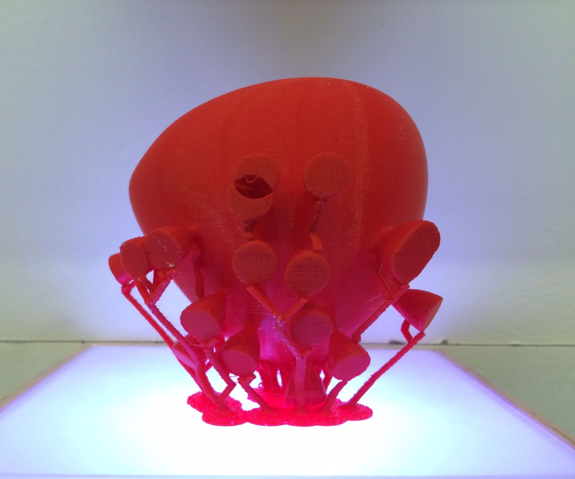

Step 1: 3D Print a Clay Mold
Using a 3D modeling browser based or software program, create a form for the glass to be blown into. The important part is the size of the opening, this depends on the skill of the glass blower, with the larger the opening the easier. in this case both example pictures have an opening of at least 4 inches, which is a good place to start.
Printing with the clay mix of your choosing, in this case a cone 10 B-mix with grog were used to print or hand work the shape. Again an important dimension is the height of the piece, this is open to experimentation but the pieces that faired the best were pieces under 6 inches tall.
