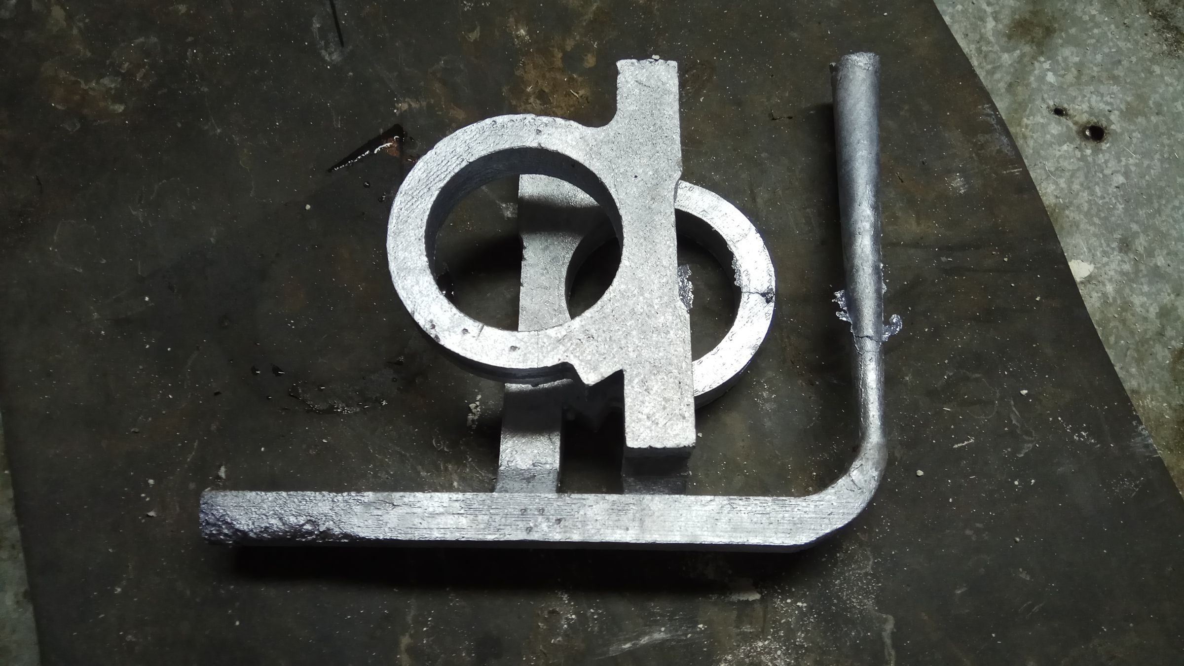

Step 6: The Casting Result
I would say that the result was very good, the detail on the parts exceeded my expectation!
Anyway, there are a lack of feeding on the top of the parts, next time is good idea to implement some feeder.
You could see on the last image that the initial slug has been retained on the runner, this was done on purpose to avoid the initial slug to get on the parts.
