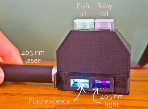

This Instructable shows how to improve on the standard Public Lab DIY Spectrometry Kit, by using a 3D Printed main body. One main improvement of the new design, is a robust provision for securing the USB cable.
The current device can easily be carried around and used in conjuction with a netbook/laptop. The body features some hole patterns for connecting it to a separate stand with integrated light source. When the design for this will be finished, it should be possible to use the spectrometer for analysing samples in standard cuvettes (square 10x10x45mm).

The new design was done in 3D, using an old version of AutoCAD. Features of the new design:
  • The 3D printed body contains an integrated, flexible clamp for securing the USB cable
  • The camera strip alligns in a slot and attaches with three very small, self tapping screws
  • The card insert fits into the printed body, without gaps
  • Several holes are present in the main body, for future use. They can be tapped to M4 size, using a manual tap. I am planning to design a separate stand, for using the spectrometer to analyse samples in standard cuvettes (square 10x10x45mm)
Attached to this step are an Acis file (Zipped) and an STL file. The Acis file can be opened by several CAD packages for editing. An example is 123D Design, which can be downloaded for free. The STL file is to be used for printing on a 3D printer.

Step 5: Conclusion
The new design allows the replacement of the conduit box and wooden block by a purpose designed part. The resulting spectrometer provides a better fit for the camera and the card insert. It is also a bit more robust due to the provision of an integrated clamp for the USB cable, making it more suitable for carrying around.
