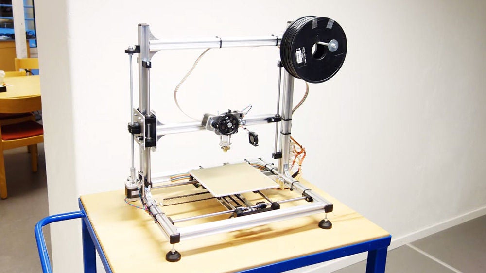

4. Entry Level Manufactured 3D Printers (FDM)
Next, we go over some good options for entry-level 3D printers, hopefully helping you decide which one's best for you if you're still on the fence.

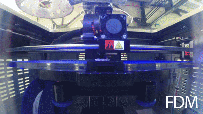

Extrusion Technologies:
FDM (Fused Deposition Modeling) / FFF (Fused Filament Fabrication): This process uses a nozzle that extrudes a heated medium in a liquid state onto a build platform (one slice at-a-time). The extruded material cools instantly into a hard material that the next slice is built upon. Think of it as a hot glue gun on a mechanical gantry; the glue gun draws a shape on the platform in 2D, then moves up one level (slice) and draws the next 2D shape. Stacked on top of each other, the slices form a complex 3D shape.
  • Pros: Inexpensive material, durable, variety of machine and material manufacturers.
  • Cons: Low resolution, slow build speed, failures on overhanging features.

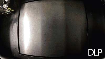

Light Polymerized Technologies:
DLP (Digital Light Processing) / SLA (Stereolithography): This process covers a range of different printing types in which a liquid medium is laid down on a build platform in successive slices (in much the same way an inkjet printer prints). The layers are hardened with UV light, and successive layers are built upon each other. Many DLP printers, such as the Objet series by Stratasys, print a soluble support material along with the hardened resin in each slice, effectively encasing the finished print. This ensures a perfectly smooth surface and eliminates the need for support structures.
  • Pros: High-resolution objects, overhanging features are a non-issue.
  • Cons: Limited build areas, low durability, high cost.

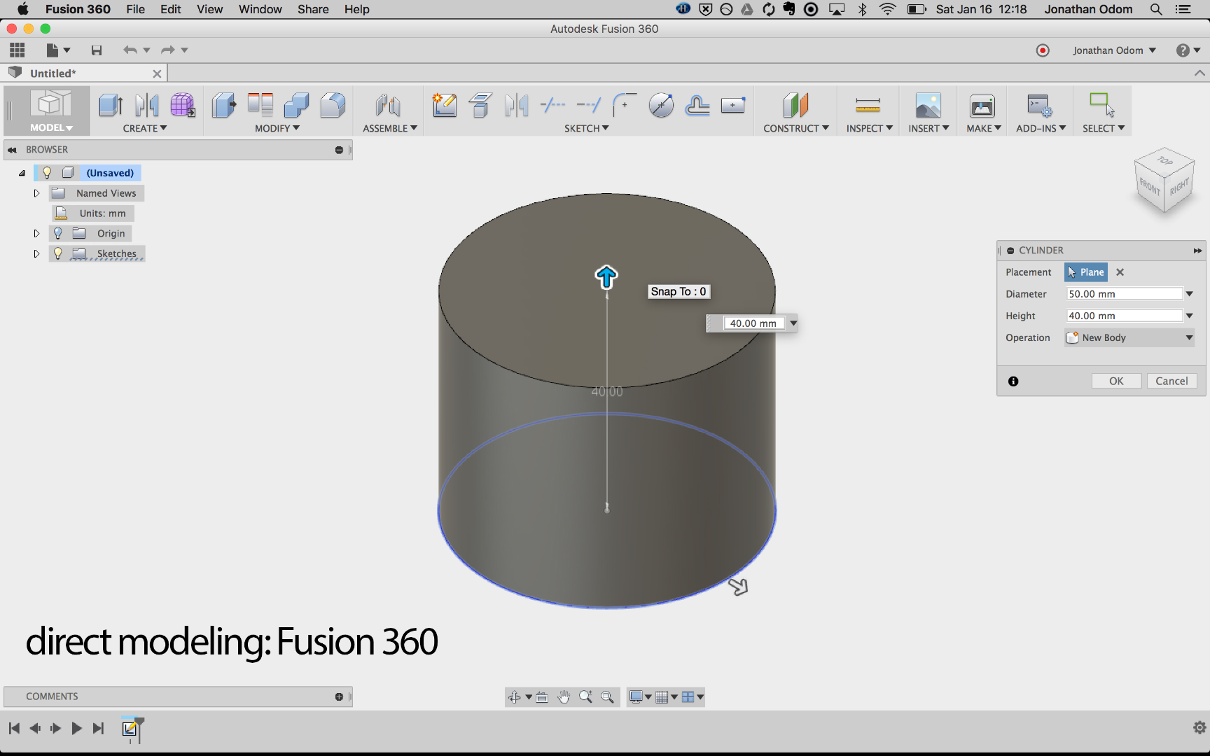

Direct Modeling:
Direct Modeling is simply the process of creating a 3D model through the process of manually altering a 3D object using a number of different geometrical creation and manipulation techniques. The types of modeling geometry most commonly used in direct modeling are below.
Solid Modeling: Within solid modeling software, 3D objects are treated as solid objects as opposed to hollow shells. This type of modeling is very useful for designing 3D objects that are (for the most part) ready to print on a 3D printer. Solid modeling helps the user avoid model issues such as walls that are too thin for the printer to build, and holes in shells that can cause printing errors.

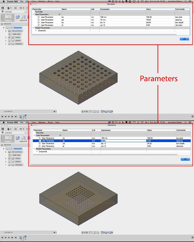

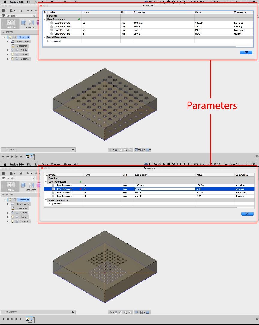

Parametric Modeling:
Parametric Modeling is the process of creating a 3D object through the use of parameters. This method is usually mixed with direct modeling to some degree, but objects can also be designed exclusively through parameters. Parametric modeling can be done using any kind of 3D geometry.
In Fusion 360 or Solidworks, parameters can be as simple as a variable representing the diameter of a hole in an object. Using a global parameter allows the user to change the value and have this hole diameter change in every place it occurs in a model.
In Maya, the user might write a complex Python script to create a complex object with little or no direct modeling. Rhinoceros has an open source companion called Grasshopper that gives the user a graphic interface, allowing her to visually design the parameters as a series of functions and links.
Openscad is an open-source parametric 3D modeling program that uses solid geometry. From the company's site: "OpenSCAD is not an interactive modeler. Instead, it is something like a 3D-compiler that reads in a script file that describes the object and renders the 3D model from this script file. This gives you (the designer) full control over the modeling process and enables you to easily change any step in the modeling process or make designs that are defined by configurable parameters."

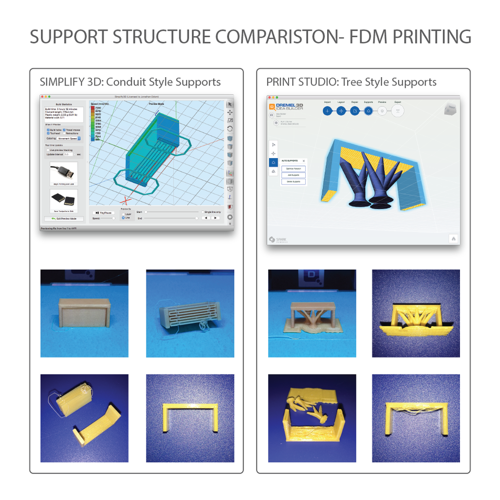

Slicers not only create the machine code for the 3D printer to follow, they create the support structures. Slicers like Meshmixer and Print Studio are free and produce generally great results with easy UIs, but at the moment, they only work with tree-style support structures. These types of structures work very well for DLP 3D printers, but if you've got any kind of significant overhang in a model printed on an FDM machine, you need parallel wall type support structures.
MakerBot's software has these kinds of supports, but their software only works with their machines. Cura by Ultimaker has these kinds of support structures and it's free, but I find the software to be difficult to use and the results are poor for me.
Simplify 3D costs $150, but it's incredibly easy to use and has produced flawless prints every time I've used it. Not only are the surfaces smooth and accurate, the support structures snap off effortlessly and require practically no cleanup. You've already spent money on a printer, just put in the extra $150 for Simplify 3D and get the best results possible.
The guys at Print Studio are working on these kinds of supports, so hopefully later this year I'll be able to recommend this free software.

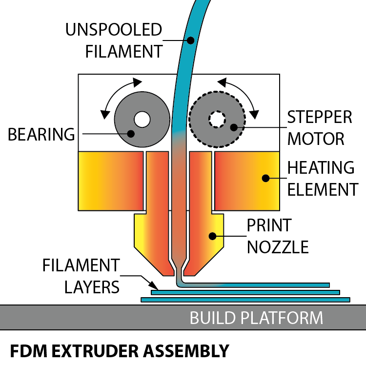

  4. Extruder: An assembly consisting of a stepper motor, a heating element, and a print nozzle. The stepper motor draws the filament into a heated core and through a print nozzle. The heating element brings the filament to a consistent temperature that allows the melted filament to be applied to the bed and successive layers of the cooled filament.

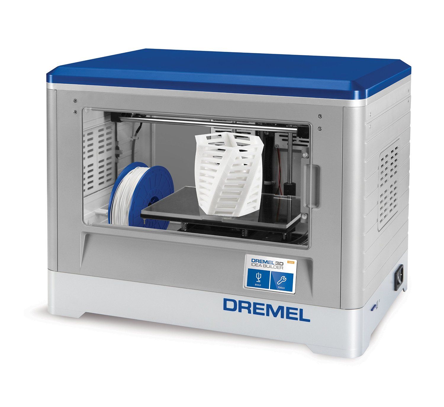

Dremel 3D Idea Builder ($800)
  • Build Volume: 9” (230mm) (X) x 5.9” (150mm) (Y) x 5.5” (140mm) (Z)
  • Materials: PLA
  • Pros: Affordable, reliable, easy maintenance, quiet, great customer support, files pulled from internal memory, excellent machine interface.
  • Cons: Inferior support structures for substantial overhanging geometry (3rd party software can solve this problem).
The Dremel 3D Idea Builder is a sign of things to come: a long established, profitable hardware company has learned from the startups and entered the market with an affordable, widely available 3D printer.
Here is my experience with the machine: With heavy, regular use for over 9 months, the machine is still working well. Filament jams are rare and easy to fix. Printing failures happen maybe 15% of the time (which in my experience is comparable to the Rep-2).
I recommend this machine because it's ready to use right out of the box using very simple software. It's the right mix of affordability, build volume, and user-friendliness.

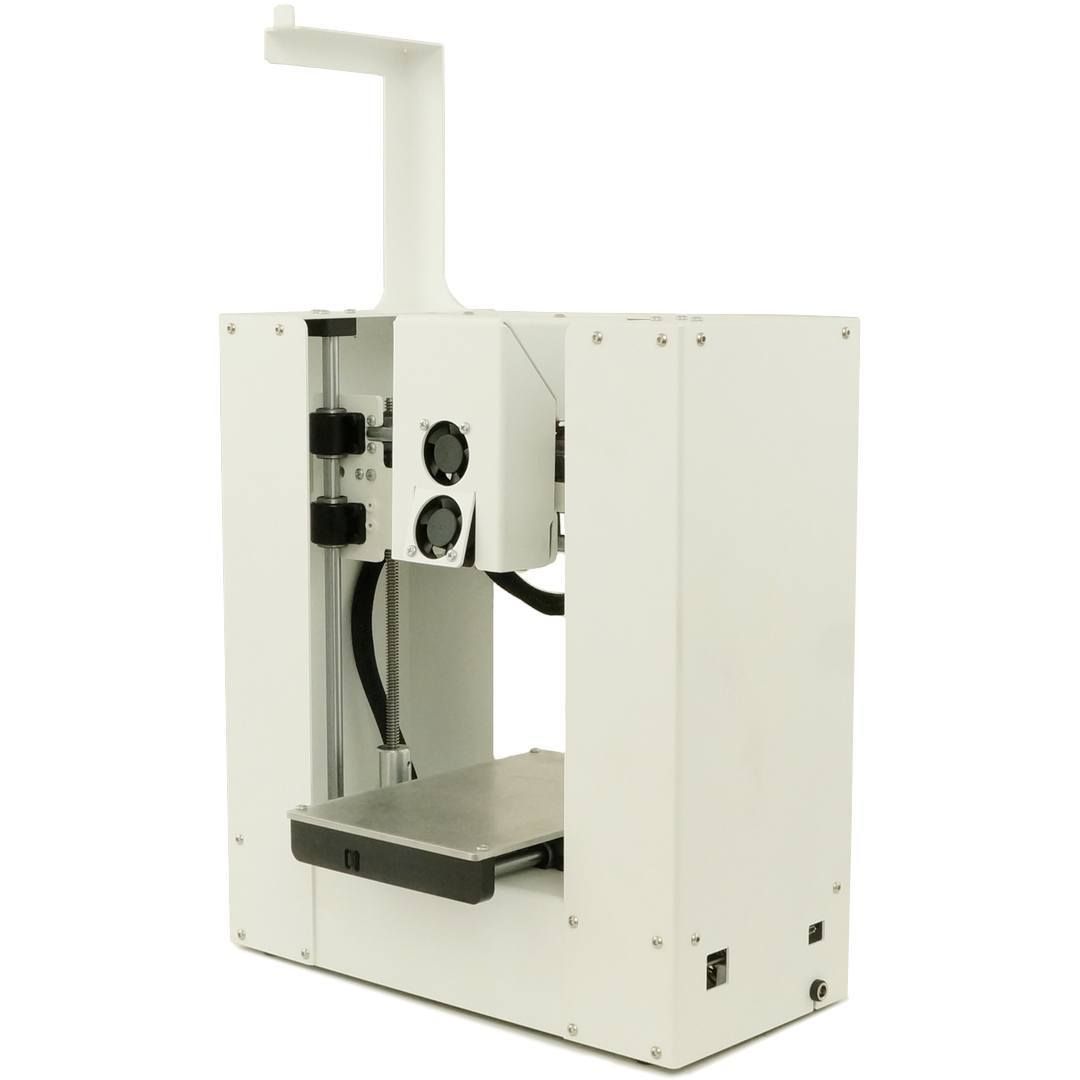

Printrbot Play ($400)
  • Build Volume: 4" (100mm) (X) x 4.1" (105mm) (Y) x 5" (130mm) (Z)
  • Materials: PLA
  • Pros: Very affordable, reliable, easy maintenance, great customer support, files pulled from internal memory, seriously well built.
  • Cons: Small build volume.
The Printrbot Play is an amazing little machine. $400 for a 3D printer that's this well made, has internal memory, and has really good tech support is pretty amazing. The only issue with this one is that it's got a small build volume. If you're looking to get started with 3D Printing on a budget, this is the printer for you.

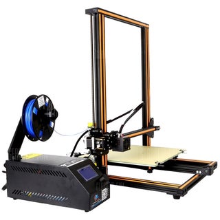

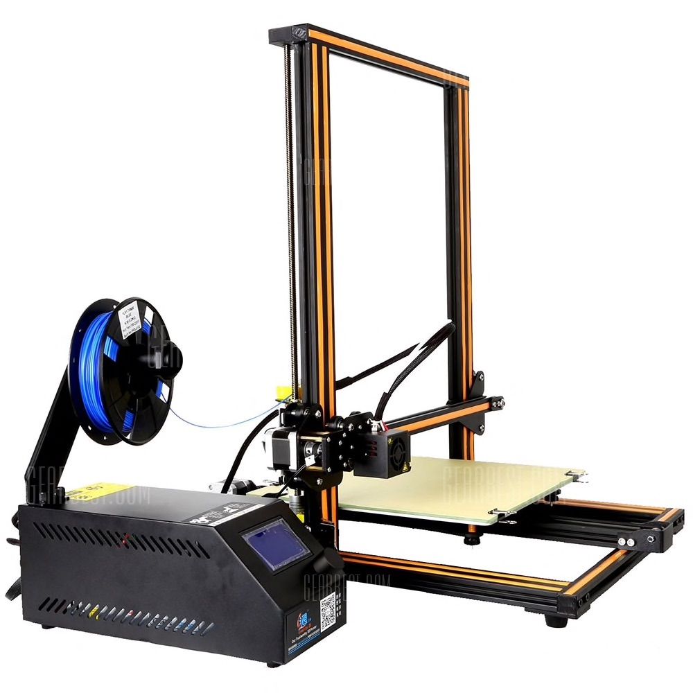

Creality CR-10 ($400)
  • Build Volume: 11.8" (300mm) (X) x 11.8" (300mm) (Y) x 15.75" (400mm) (Z)
  • Materials: PLA, ABS, HIPS, Nylon, PETG
  • Pros: Very affordable, high quality prints, huge build volume, easy to unclog / repair, customizable, heated bed (allows for much wider range of filaments and prevents prints peeling up), on-board computer control, fast nozzle heating.
  • Cons: Some assembly required, takes up a lot of space, not a simple, self-contained box (power supply and printer are separate objects connected by cables).
In terms of bang for the buck, this is the best printer I'm aware of. The build volume is huge but it's still less than $400. It's a bit messy on a desktop because the power supply and printer are separate, but that's a small price to pay. The print quality is excellent in my experience, the heated bed opens you up to a whole range of high-performance filaments, and even though it's sold as a "kit", it basically just comes in two parts that screw together and a bunch of cables you have to plug in. If you're a little more savvy with machines and not intimidated by some assembly, this machine can't be beat.

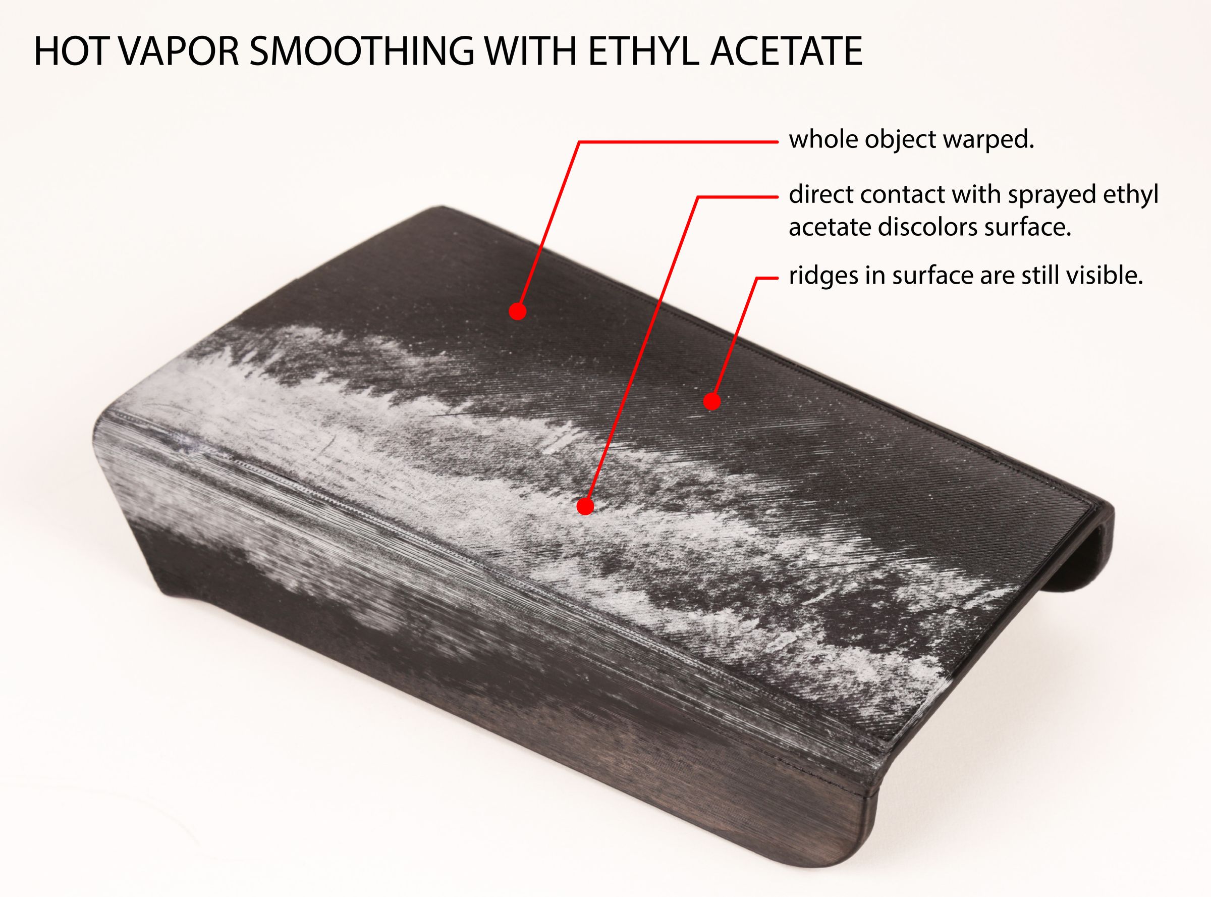

Hot Vapor Smoothing
With this method, MEK is heated and the vapor is trapped in a closed container with the printed part. MEK is highly toxic and is outlawed in California, so I gave ethyl acetate (EA) a try. Remember that EA shouldn't be anywhere near your lungs, and heating it will make for a higher likelihood of inhalation. It's also highly flammable, so heating it up comes with another set of risks.
I tried the rice cooker method, and the results were not good. The ridges were still highly visible in the end, there was white discoloration on the surface in some places, and the entire part became warped and weirdly flexible within 2 minutes of exposure.
Perhaps with more experimentation this would work better, but I prefer the epoxy finish from Lesson 11 because it's easy to control and produces good results.
