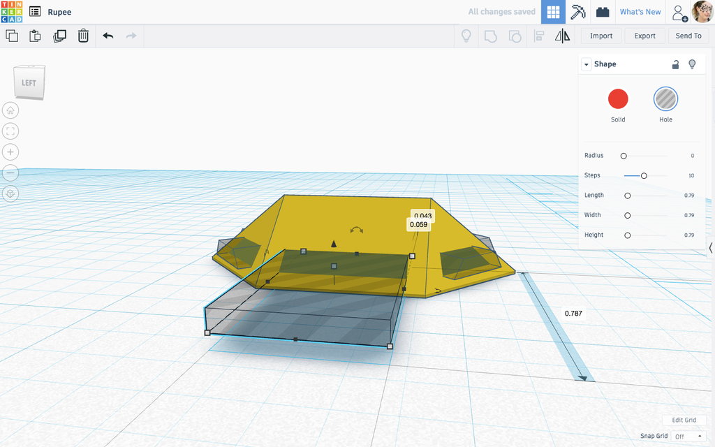

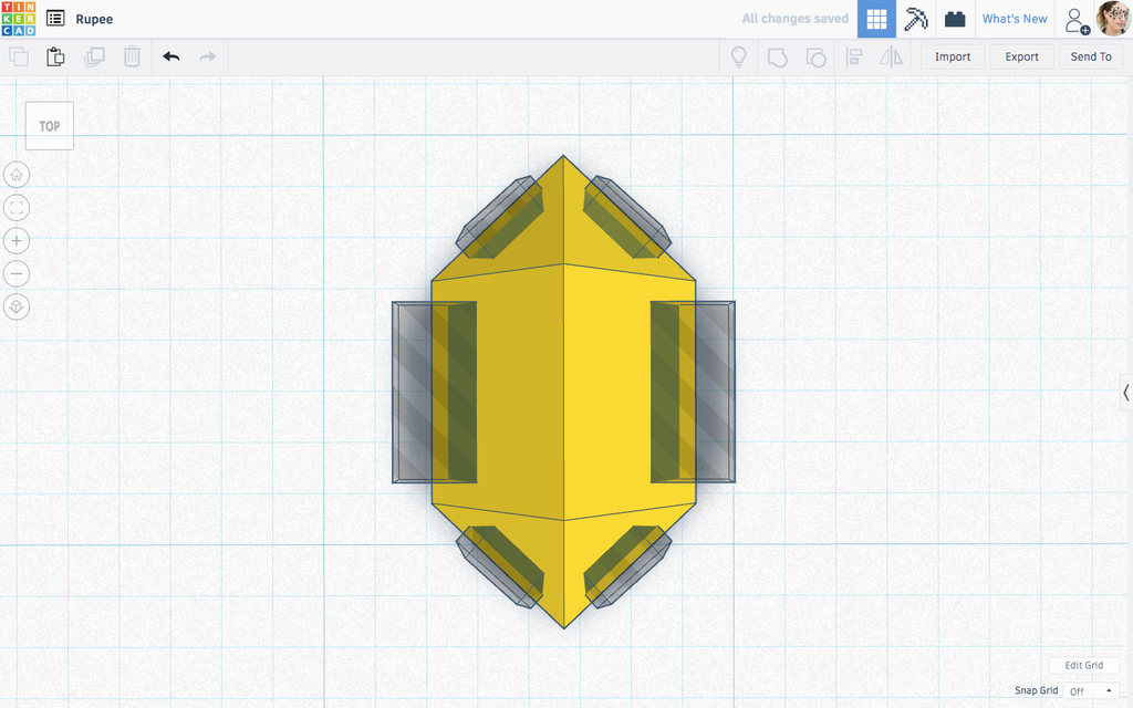

Time to make the cutouts. I used distorted roofs with the tops cut off with rectangles to make cutouts for the top and bottom ends.
For the center, I just needed a rectangle cutout.
Make sure everything is lined up right. I tend to use align a lot and the ruler.
Now I have all the side cutouts, but I still have the bottom and top to cut.
To cut out the bottom, I copied my shape and kept ungrouping until I had the original 3D rupee shape (what I labeled SHAPE A above). I shrank this down until I was happy with the wall thicknesses and then made it into a hole to cut out the bottom and inside of the rupee.
Lastly, I needed to cut the top. This was pretty easy, I just took a rectangle and brought it up so the rupee would be as thick as I needed it and grouped to cut the top.
