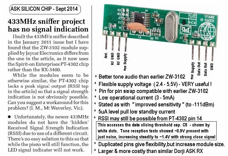

Update -Sept 2014: An improved PT4302 engined SpiritOn RXN3-B module is now stocked as Jaycar's ZW3102 receiver. Performance has been found very pleasing, & the versatile supply voltage ( 2.4V-5.5V) is especially welcome. Refer RSSI wiring details under comments at this Instructable end.RECOMMENDED!

UPDATE #2 - Sept. 2014: Aust/NZ electronics outlet now stock a pin for pin compatible PT4302 RF engined SpiritOn module as their ZW3102. RSSI (received signal strength) on this module has turned out as a breeze to organise- refer pictures! Signal clarity and module supply versatility (down to 2.4V) are appealing, and sensitivity is quite amazing. A Darlington pair driven LED allows visual signal confirmation. Reception was found good thru' light vegetation & wooden buildings to 100m, and LOS ( line of sight) signals were still "armchair copy" at 500m !
