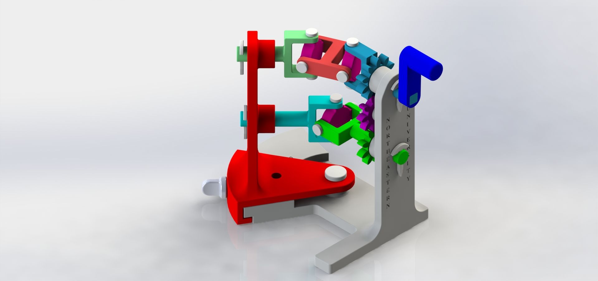

A coupling is a device used to connect two parallel shafts together for the purpose of transmitting power. This coupling transmits rotary motion from one shaft to another. This coupling uses a direct-contact method to rotate two shafts in the same direction. There are three disks mounted on each shaft with a hole bored through the disk that is not concentric to its outer diameter. These three disks are rotated 120° from each other. When the input shaft is rotated, the output shaft turns at the same speed due to the cam interaction of the disks. These steps are meant for those who wish to 3D print and assemble the 6 Disk coupling device. These steps will contain information on how to "post process" and assemble individual parts into the final device.
