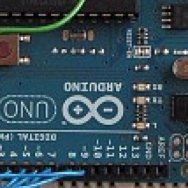

Alright, the branching could be pretty tricky when you're dealing with a common anode 7 segment display. For my case, I have a :
KINGBRIGHT SA04-11hwa.
First look for the two anode ports for me it was the 2 and 3. If you don't know how to do that there are two ways to figure out your anode ports you can either look for your 7 segment display datasheet online or you can connect a wire to the grd of the arduino and then put a connect a positive wire and try to find your anodes. When you finally did that here's what I did :
Led1 : pin 3
Led2 : pin 4
Led3 : pin 5
Led4: pin 6
Led5 : pin7
Led6: pin 8
Led7 : pin9
Led8 : pin 10
ANODE : pin 2 (basically you put the two anodes together and back to pin 2) in the picture my two anodes are the red wires
