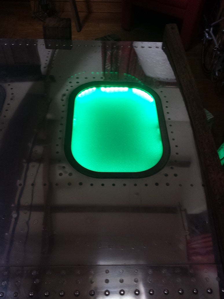

Frosting the windows. We were considering leaving the windows clear so that you could see the structure of the fuselage through them but in the end we decided against it for a number of reasons and continued to give them a frosty look.
There were a couple of options available to us, there a number of articles on how to 'frost' your own windows including taking some sand paper to them, media blasting them or just simply applying an easily available frosted film to them. As we only had our 4 windows we decided to go for the film option as this would be easy to revert if it looked wrong or we made a mistake.
1. Remove the windows from the fuselage, simple task of just unscrewing the 10 retaining clips for each window and gently pushing it out from the hole.
2. Clean the underside of the window, we did this with window cleaning wipes first as there is a small hole at the bottom of the window which we didn't want any spray to end up going in as it would then end up between the layers of the window.
3. Cut the piece of film to the rough size required for the window, this will make it more manageable than trying to manhandle the full sheet/roll whilst applying it to the window.
4. Make sure the window is completely dry and start to apply the film, slowly. We peeled off about 2 inches of the backing and used a soft cloth to make sure the bubbles were all removed when it was first applied. Then working slowly from side to side with the cloth you can start peeling away the backing and working your way up the window till the film is fully applied without any bubbles. We did consider using the method of applying soapy water to the window before putting the film on (like you do when applying vinyl graphics or window tinting film) but again we didn't want any liquid getting in that small hole and then between the window layers.
5. Using a sharp scalpel or craft knife we then worked around the outline of the window and cut the film to shape before cutting out small sections of the film where the clips hold the window in place, this was to stop the clips pushing the film and causing bubbles.
6. Now you refit the windows! ta da!
We've also had a quick play with putting some led lighting under one of the windows, watch out for another Instructable when we fit them to all the windows!
