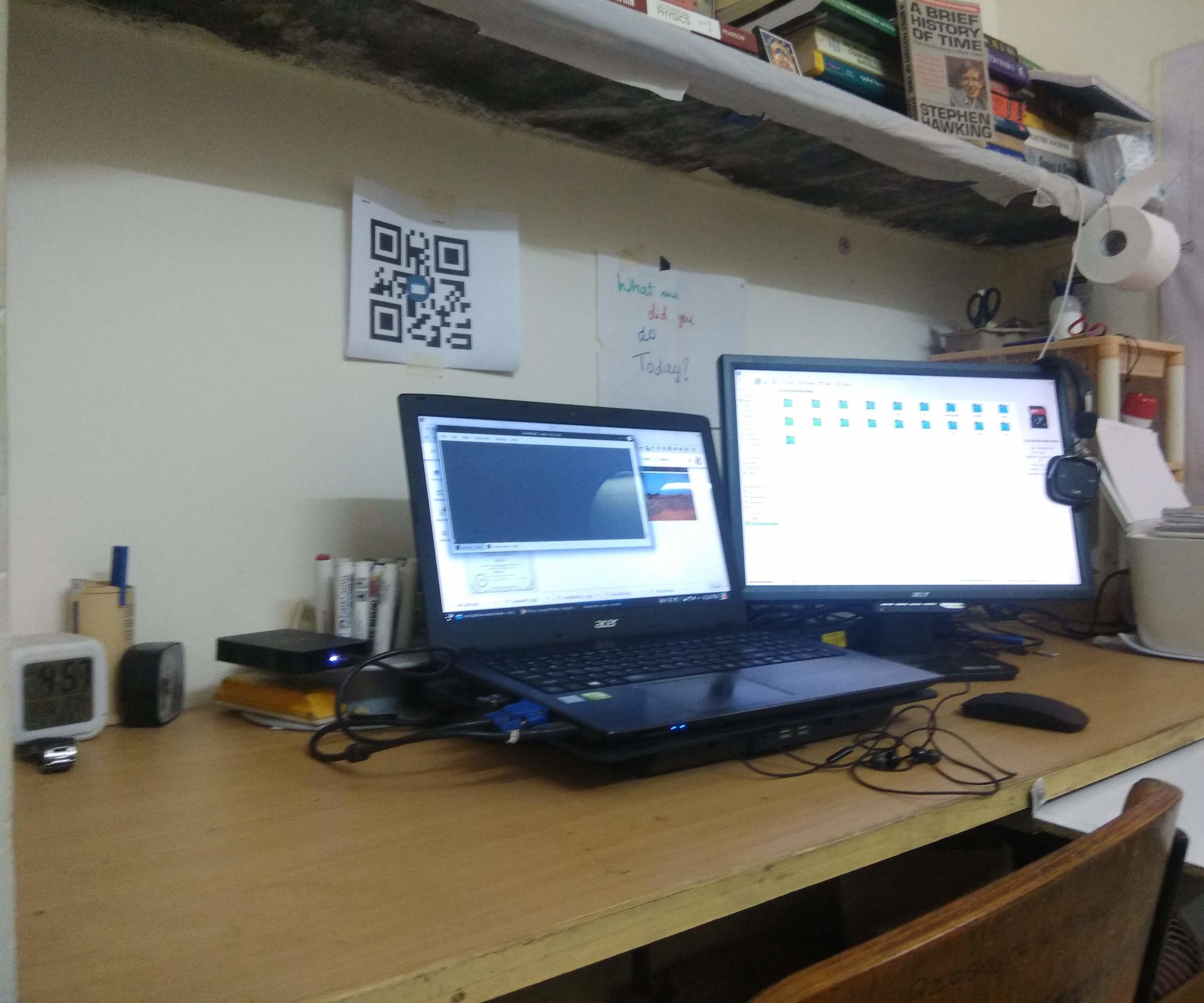

Step 6: Use It !!..
Well congratulations...you have with you a custom built power bank!!
I used it to charge my Tab and to power my raspberry pi 2 to make it portable.
