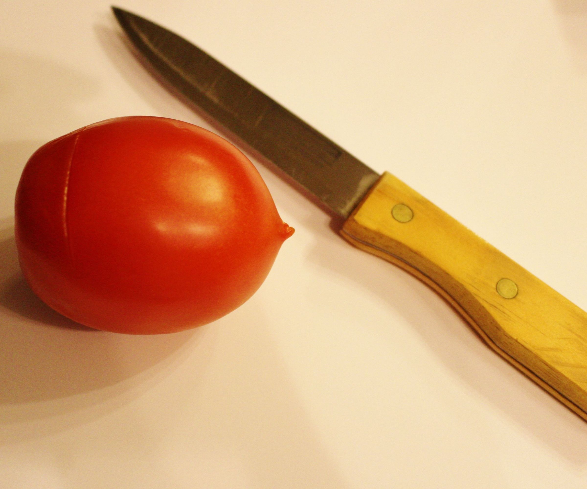

  1. Which Stone(s) Will You Use? - Look at your knife edge, and see what it tells you. Is it so dull that it can't even slice through the simplest of things? Like a tomato for example. If it is, then you probably want to start off using a coarse stone and make your way up to a fine/extra fine grit. If all you need is a quick touch up, then your best bet is to use a fine/extra fine grit.
