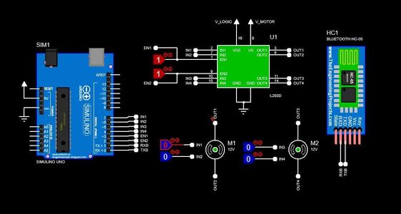

Step 6: Schematics of the Bluetooth Control Car With L293D:

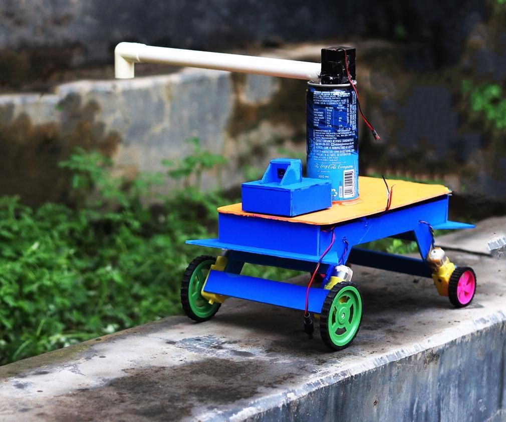

Step 7: Mechanical Part
In this step, I have made the Robot Body using PVC Boards. I
have also attached the motors with the Chassis and have soldered them with some wires.
Here is how it looks like
Then I have attached the wheels with the chassis and here is
how it looks like

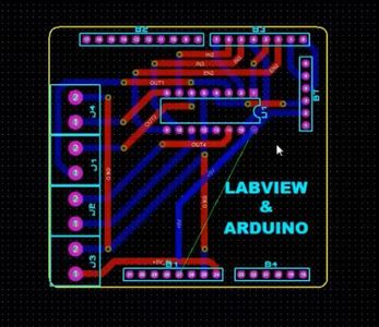

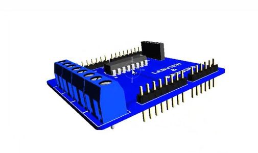

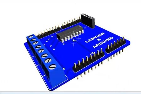

Step 8: Electronics Part

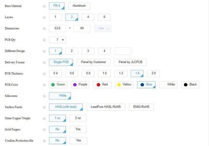

I have made a PCB file to make it easy to assemble and
ordered my PCB from JLCPCB. They are very professional in PCB making and the build time was short. I received my item within 7 working days.
After getting the PCB it was just a less than 2 minutes job to assemble all the components in a proper way.

in this step, I have attached the PCB board with the robot body / Chassis and connected the motor terminal with the output terminal of L293D Motor Driver.I have also attached the 18650 li-ion battery holder with the chassis and connected the output wires of battery holder with the input power terminal of L293D motor driver.
