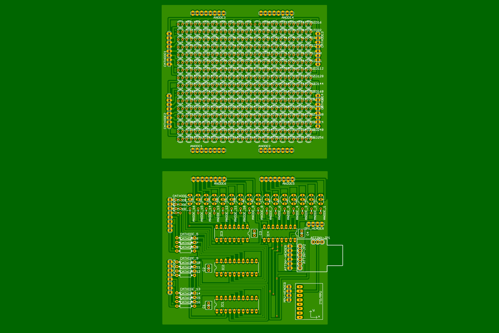

Step 4: Eagle Design
Because the protoboard 7x9cm has limited space so I took my times to design this project in Eagle software. With the same hardware configuration, Eagle PCB can control led matrix 16x16 with auto-rotating function.
I have just finished designing and did not send to fabrication company. I think it should work as same as my protoboards.
And here is my design.
  • PCB - Top view
  • PCB - Bottom view
  • PDF print file for Clothes Iron Toner Transfer
To make a circuit board at home, we can use Clothes Iron Toner Transfer method that simply print below circuit designs out on a laser printer, iron it onto the copper, and etch by Ferric Chloride.
- PCB TOP PDF FILE
- PCB BOTTOM PDF FILE
