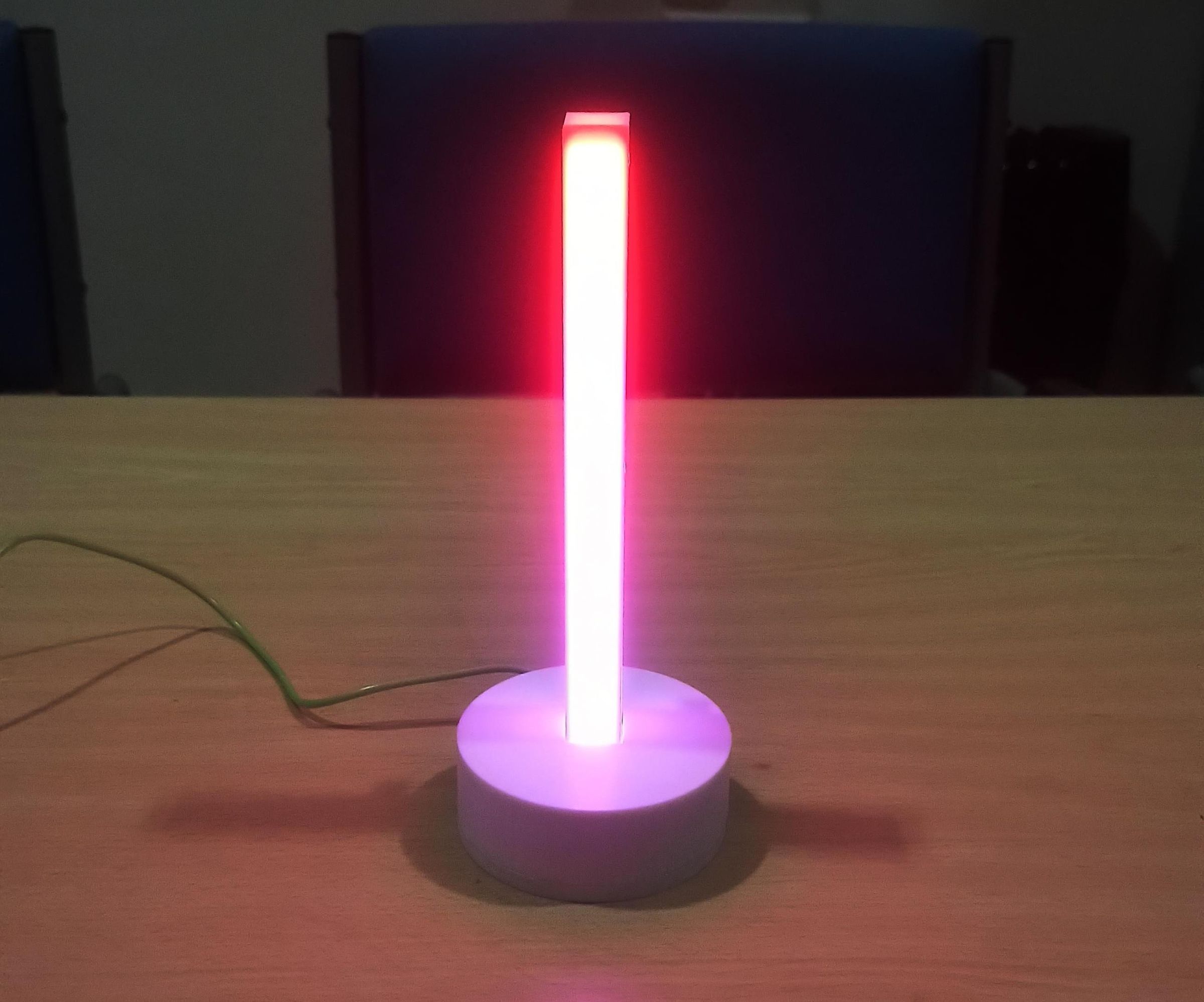

Introduction: ATtiny85 Tiny Light With Single WS2812B RGB LED
ATtiny85 (Digispark) is one of the smallest and cheapest Arduino board available in the market. In this project, we will connect a programmable RGB LED to the ATtiny board and program it to show rainbow colors. We will also create a 3D printed enclosure to make it wall/desk mountable.

Step 3: Connection
ATtiny85--> LED
5V --> 5V
GND --> GND
P1 --> Din
