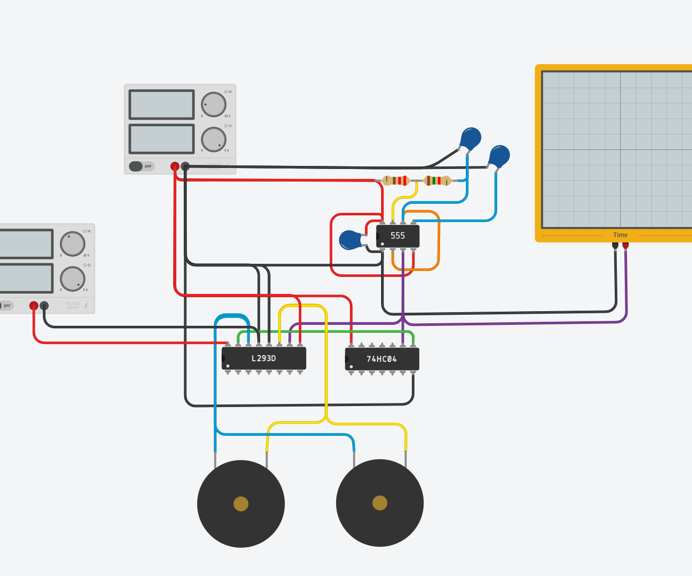

My previous Instructable featured a 555 timer with a hex inverter used to generate a 40 kHz square wave and drive the ultrasonic transmitters. As you can see, the circuit is pretty large. I thought I could avoid using an overpowered MCU for such a simple task, but found that an ATtiny (4/5/9/10) was simple enough to generate both the 40 kHz noninverted and inverted waves with only a few lines of code! This work is based on the design by Asier Marzo. The ATTiny come in SO-23 packaging and are smaller than a grain of rice allowing us to make things very small! If the smaller ATTiny 4-10 are difficult to find in stock, you can also use a larger ATTiny 85 or other MCUs with a few modifications to the attached EagleCAD schematics and code.

Power the ATTiny with a 5V source or build the voltage regulator circuit to stepdown your initial 12V to 5 V. Using ideally a two-channel oscilloscope, verify the outputs of PB0 and PB1 are 40 kHz square waveforms that are 180 degrees out of phase and 5 Vpp with respect to ground.
Step 3: Method 1: Breadboard/Protoboard: Build the Circuit Depicted in the Schematic
If you haven't already built the voltage regulator portion of the circuit, do so and feed the 5V output into VCC of the AT Tiny. Feed the outputs from the ATTiny into IN1 and IN2 of the TC4427 gate driver following the schematic and power it with 12V directly from the source. This should boost your square waveform signals from 5V to 12 V. The outputs of the gate driver are directly connected to the two ultrasonic transmitters. I used nylon screws and spacers to adjust the transducers ~17 mm apart. If you are using 12 mm tall transducers, use two 20 mm hex spacers and a 1 mm nut in between the boards. The 41 mm separation minus two 24 mm for transducers results in 17 mm between the emitting surfaces. This allows 4 nodes to form.
