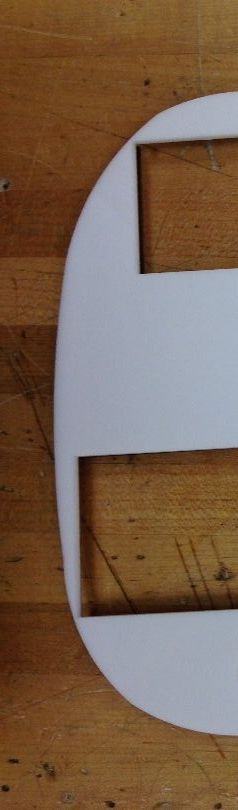

Step 6: Putting It All Together
On a completely flat surface, glue the fish tank together and clamp each side in two spots to prevent the acrylic from bowing. To ensure your tank has a clean appearance, try to keep the glue from oozing out of the seams. Once this is clamped and placed off to the side, do the same for the electronics housing. Let the, dry for 48 hours. Then, take your sealant and place it on the seams and edges. It will fill in wherever water would, making your tank water-tight. Let this set for 72 hours, then attach the electronics portion to the back of the tank using the bonder. Let set for at least 24 hours.
Step 7: Setting Up the Feeder
Lastly, place your electrical components into their section. Glue the servo to the top edge where the tank and the housing meet. Fill the holes with some fish food and you're good to go!
