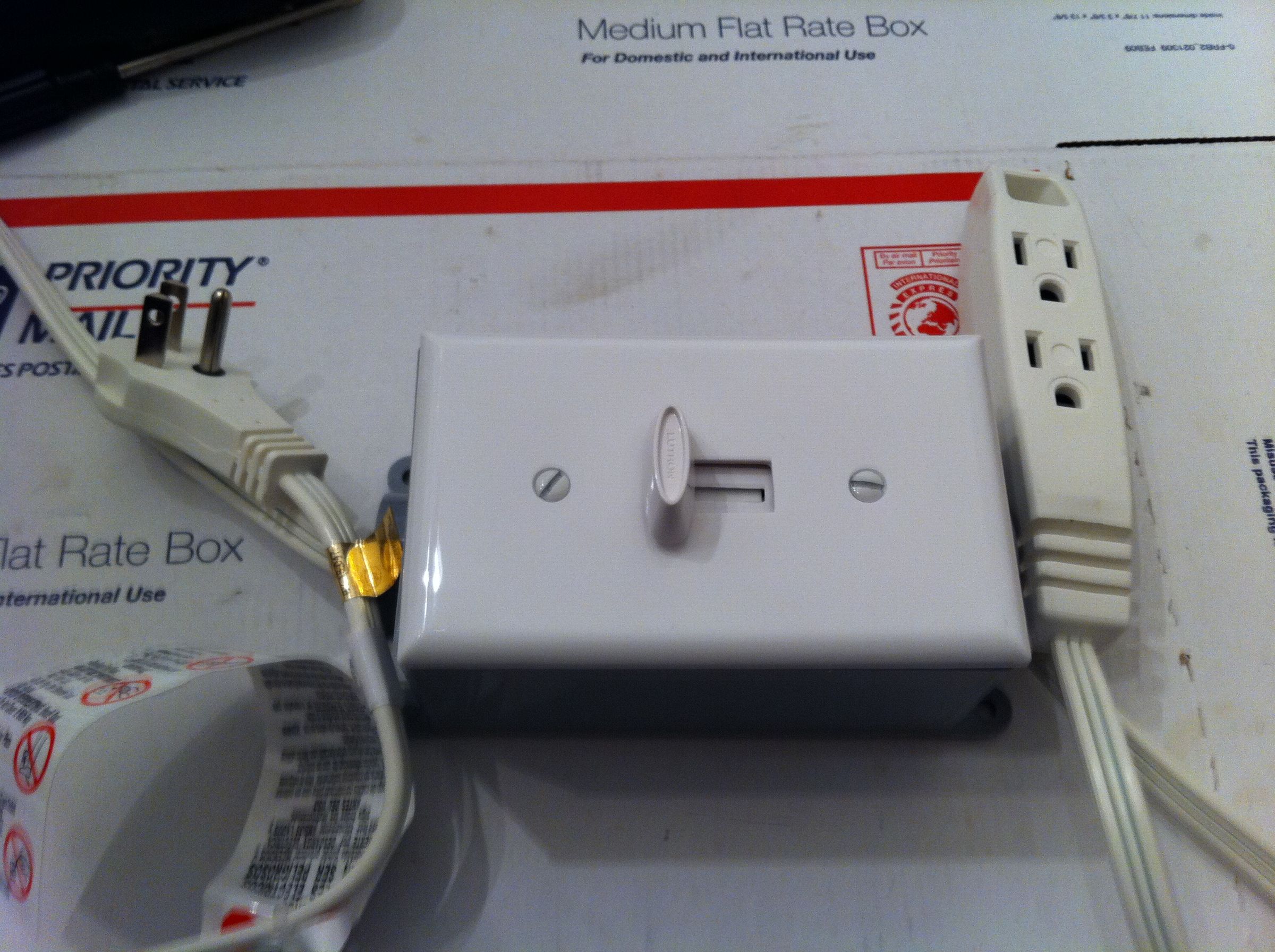

Step 1: Blue Canary in the Outlet by the Light Switch
The front panel display on this clock is mega bright. Like I could read by it in an otherwise dark room. I don't need a night light; my room is already bright enough from miscelleneous computer equipment and a nasty sodium safety light that's mounted outside the window.
The problem with this bright display is that there's no way to turn it down, so that's something we'll have to address.
