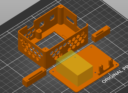

Step 1: 3D Printing Case and Support
I packed everything in the case which has a lot of holes for better air circulation. The STL files are provided so you can print it if you wanna make one.
I also designed support pieces for the LCD. You will need to 3d print and add them to the LCD.

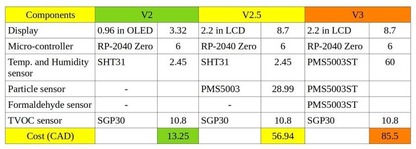

Step 5: Modification and Future Development
As you can see the new version cost a lot more because of the PMS5003ST sensor.
The price is 85.5 for main components only compared to the 13.25 of version 2. That is for the particular matter and formaldehyde function.
You can reduce the cost by using the PMS5003 and SHT31 together and the cost will be around 57 CAD (version V2.5) and you won’t have the formaldehyde level. Actually, you will only need that if you have 3D printer running around you.
For normal air monitors the V2 or V2.5 should be enough. I would add another CO sensor in the future as well as gas sensor cause I have a gas furnace running. The beauty of this new PCB is that you can add more sensors if needed. There are two I2C ports on the PCB for any extra sensors.
