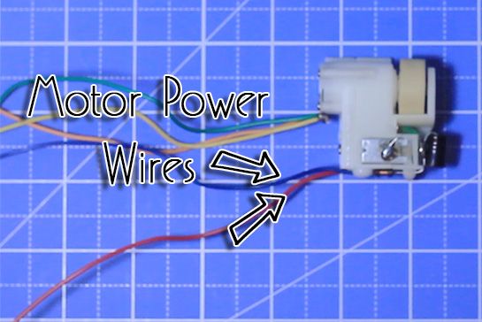

With this knowledge, I found schematics online showing how the motors that move the eyes and mouth were connected. Finding that the red and blue wires on each motor were for power, I stripped them and connected them to a 9v battery to see if there was any movement in the motors. Nothing. These servos are dead dead. That means we're going to have to dig deeper and replace the servos all together.

Once I was able to get to the servos, I tested them again and found that they were completely dead. So I decided to just replace them with newer servos. I wanted to retain the rubber wheel and gear fixture, however, because this is what keeps the servo mounted inside the head and turns the facial expressions. What I ended up doing was removing the motor and most of the gears, salvaging the last gear to mount atop a new servo. I then positioned this new servo and gear so that it turned the wheel. Then I used a Dremel to shape the plastic casing so that the new servo would fit. Then I just hot glued everything in place. Before continuing I tested out the servo by connecting it to an Arduino and then loading up the Servo Sweep sample code. It worked perfectly! So after doing the same thing for the remaining servos, I put them all back inside the head.
The wires for the new servos needed to run from the head, through neck into the body, so I had to solder some extra wire to make the wires from each servo longer. Then I ran them through to the body (making sure they were all labeled so that I knew which motor each set of wires controlled), and then I put the Teddy Ruxpin back together.
