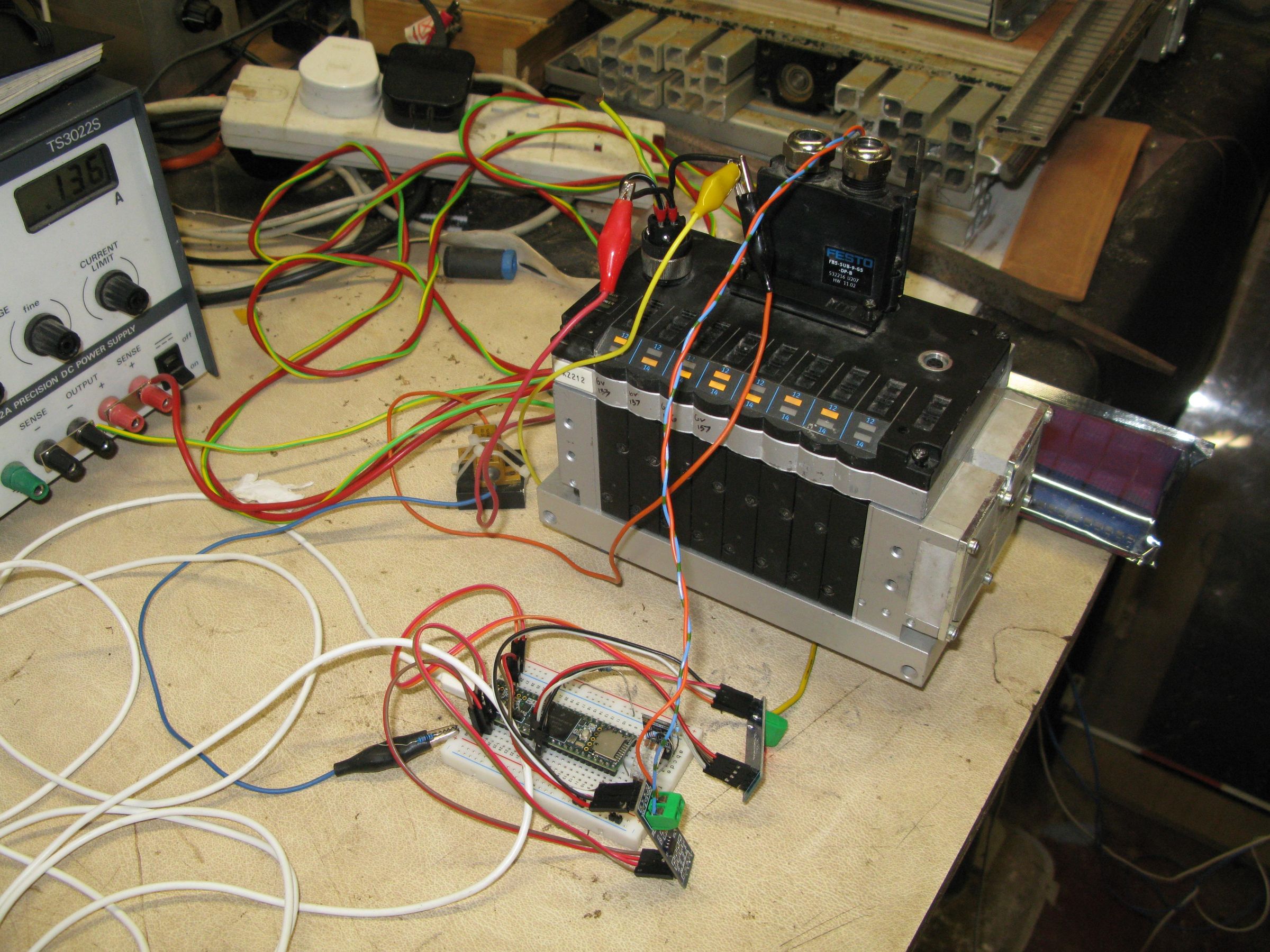

The ESP8266 runs from 3v3 so either you run it from an external regulator or convert a nano. I have used a clone nano with a CH340 usb chip. I have two different pcb layouts i know of, but hopefully this will cover most layouts.
We need to replace the 5V regulator with a pin compatible 3v3 one , 1117-3. then route the 5V in from the usb socket only to the regulator and connect everything else to its output. luckily this can be achieved by removing the input diode replacing the regulator and adding one wire from the input side of the diode to the Vin on the nano board.
check you can program the nano after the conversion.

Connect up an IR transmitter available on ebay or build one . You should use an 850nm IR led as these are the most common in receivers. The IR library used D3 as its TX pin
The alexa word gets passed to the nano, so from here its nano with voice control.

Connect the ESP to the nano as shown 3v3, gnd and TX to nano D2 soft serial. if you have the nano on usb to a serial comms display on th epc it should show what it receives from the esp.
