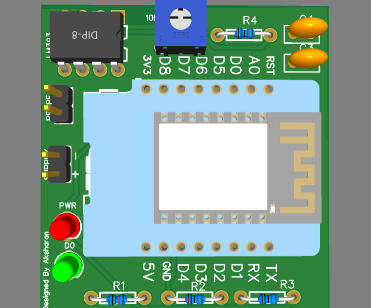

Step 5: Simulated 2D and 3D Design View
This is how our board will look!
