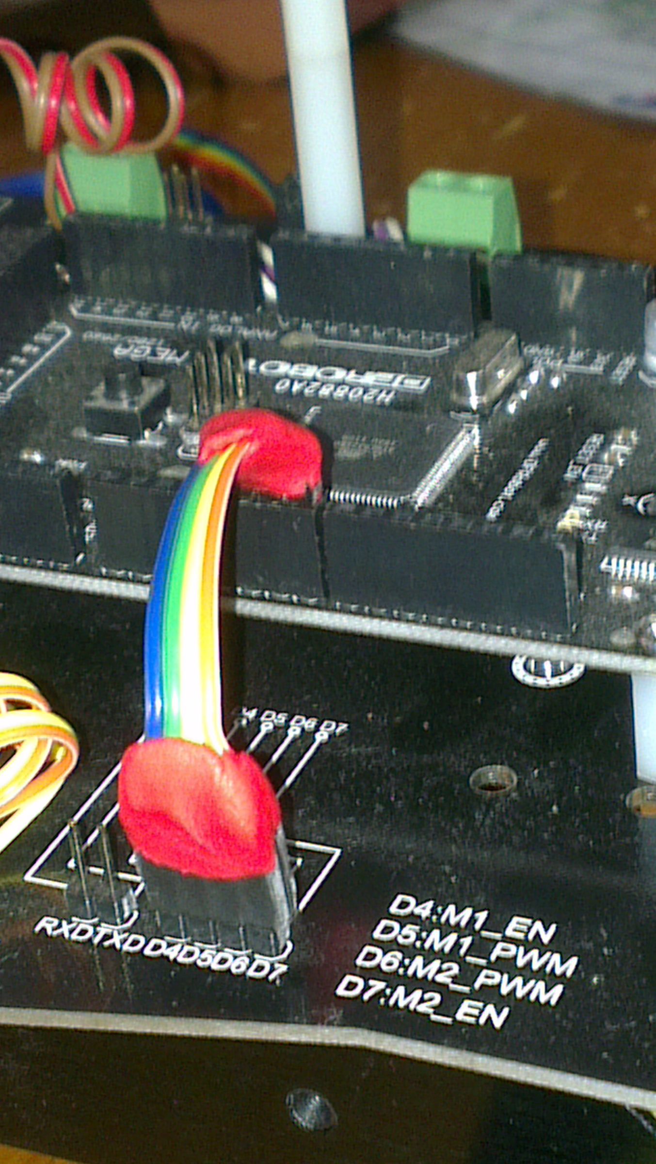

Next to the power connectors connect the "VIN=M_VIN" this will save you connecting a second power supply.
Ensure all the jumpers are set so that the Romeo uses pins 4, 5, 6 and 7.

For connecting to the Android phone so we need to add bluetooth, I got one of these - http://www.sparkfun.com/products/582 .  This by defaults waits a long time at start up, this can be changed, and I suggest you do, read the doco on the product you get to find out how.
When the bluetooth is connected to pins 0 and 1 it gets in the way and prevents you programming the Arduino.  The answer to this was to connect the bluetooth power to one of the digital out pins, as the digital pins on a Arduino cannot supply enough amps to power the bluetooth I used a PNP transister as a switch that will turn the bluetooth on and off using the digital pin out.  For this I chose pin 12.

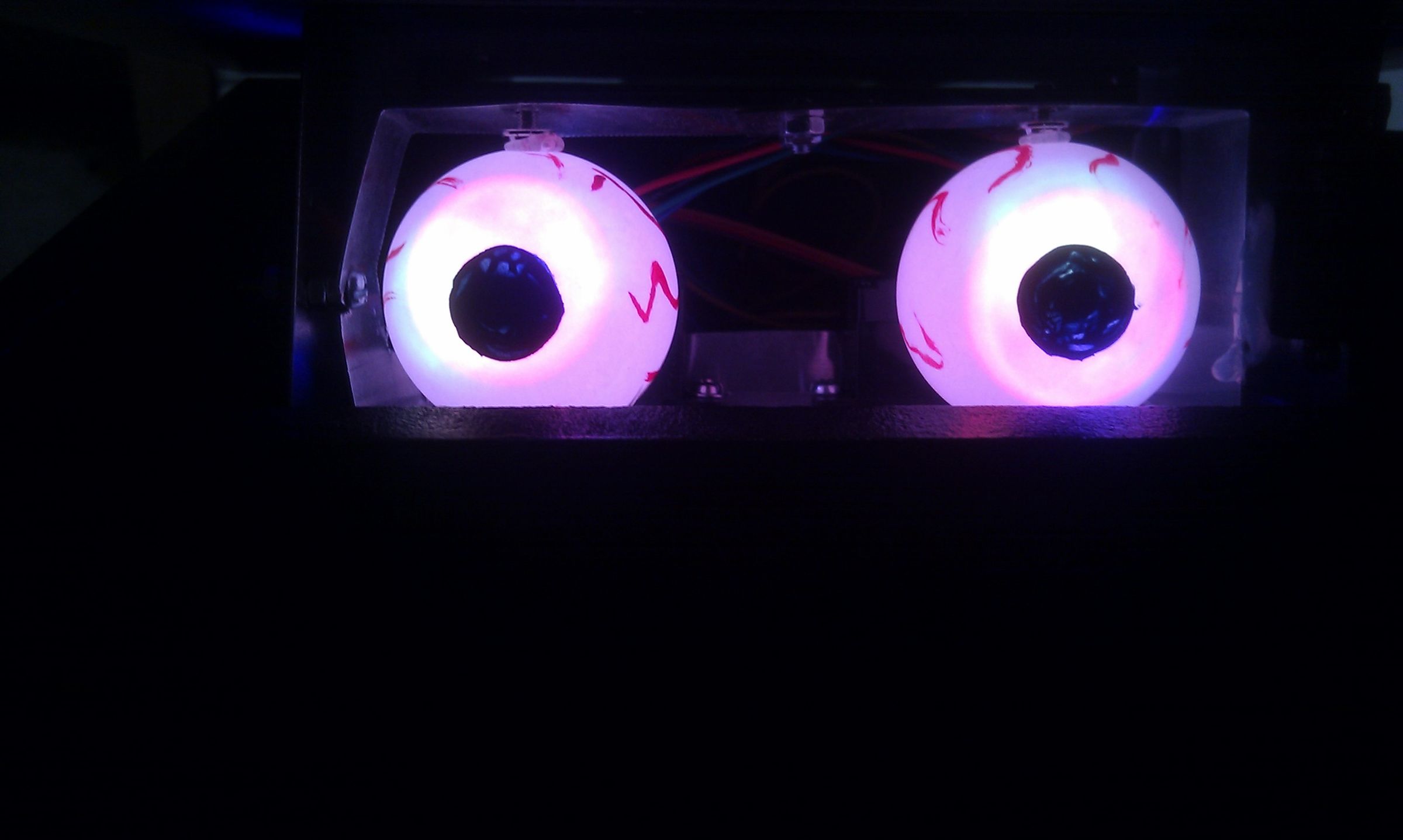

There was absolutely no need for it, but I felt the robot needed some lights that will flash.  We have already mounted 4 of them with the light sensor, however we have not wired them up yet.  Also Cylons have them, KITT have them, so I figured I also needed red lights moving from side to side.
This is simply 10 X red LEDs and 10 X 330 Ohm resistors.
Now we get another one of the protoshields we used earlier and mounted two 74HC595 chips on it.  Refer to the Arduino tutorial for the circuit http://arduino.cc/en/Tutorial/ShiftOut .  I used digital pin 11 for ST_CP (latch pin), pin 12 for CH_CP (clock pin) with data on pin 2.  I also set aside pin 3 for future expansion it could be used on a second set of 74HC595 chips if needed in the future.
Into the first chip connect the LEDs on the light sensor protoshield.  Left front is pin 0, right front is pin 1, left back is pin 2, right back is pin 3.  Pin 6 and 7 of the first chip goes to two of the red LEDs along with the 8 pins of the second chip.
