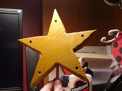

I wanted to get a really nice distressed finish on the star, so I started by applying a generous coat of stain. I used Minwax "Natural" stain and applied using a cheap brush, I let it soak in for about 5 minutes and wiped down all the edges with a rag to ensure I didn't get drip marks or streaks. Then I let it sit overnight before wiping it down one last time.
Next I applied a coat of yellow acrylic paint to the front of the star. You could use any color paint, but this paint I found was the exact color I was going for so I didn't have to do any mixing. I let the paint dry for about 30 minutes before moving on to the next step.
Step 5: Distress It!
This is probably my favorite step, because the antique look really starts to come through. Plus there is an artistic element to sanding, which is usually just annoying and painful :) I used 100 grit sandpaper and started working at the edges to remove portions of the paint. Once I had the edges about where I wanted them, I started working on all the points of the star to wear (ever so slightly) the paint away. I think I even got carried away and worked at the middle of the star a bit. Either way, I just kept checking the area I was sanding frequently to make sure I wasn't getting too rough with it. I think another important part is to make sure you vary the amount of pressure you apply to the sandpaper so the worn spots don't look too uniform.

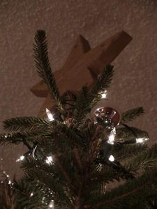

To finish off this project I got out the trusty glue gun. First I filled the LED holes with glue, stuck them in and let them cool. Then I filled in the front of all the holes with glue to make the light disperse better. Then, just for added support, I glued all the wires down to the back of the star.
Finally, put the star on your tree, plug it into the wall or a spare receptacle from your string of Christmas lights, sit back and enjoy!
