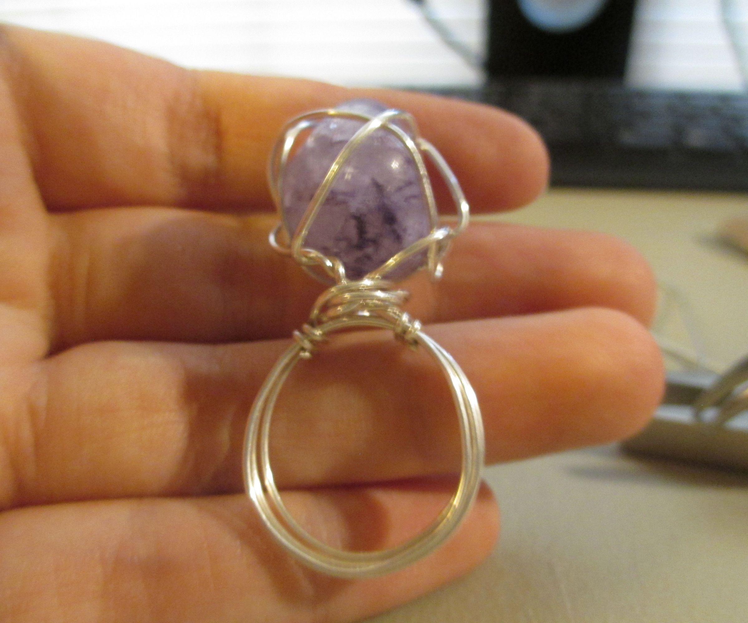

This tutorial shows you how to wire wrap a cabochon with any design you want on the front. For this one, I chose a heart, but I've also made one with a Christmas tree (for Christmas) and you can personalize yours according to your stone and the design you choose.

Fold your 20-gauge wire in half and make a U-bend in the center with round nose or bail-making pliers. The size you want depends on how thick you want your bail (the part the necklace hangs from) to be.
