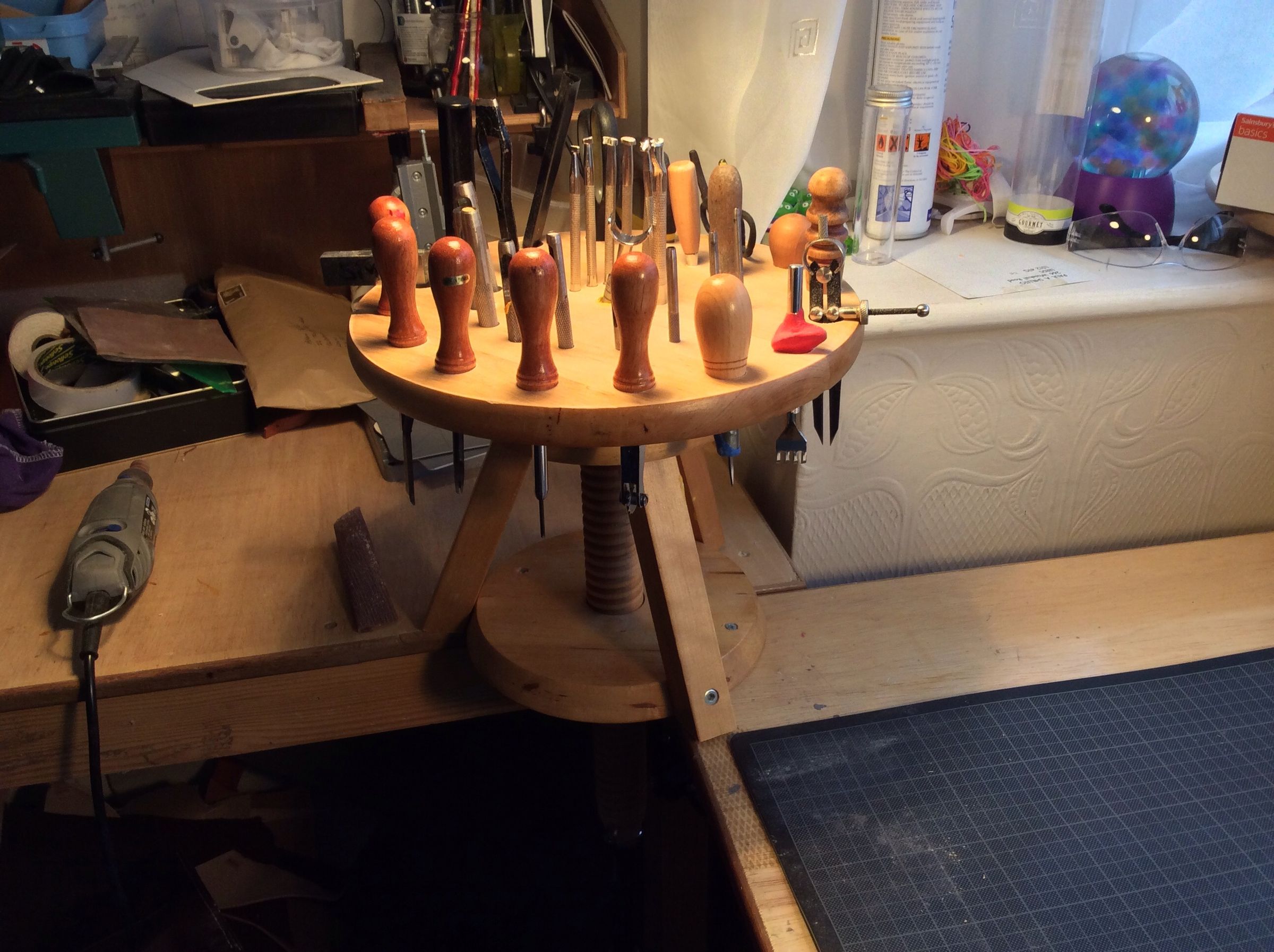

Using photo references for both my head, and for the spacesuit (Cmd David Scott, Apollo 15), Sharon sculpted the figure in a hard wax, using a range of dental tools and some handmade tools she has crafted for specific tasks. Also uses a fine tipped heat tool to melt and apply small bits of wax to build up whilst shaping the model. The sculpt was done in several parts to make the moulding and casting process easier.
Head, body, arms and backpack were all individual pieces.
