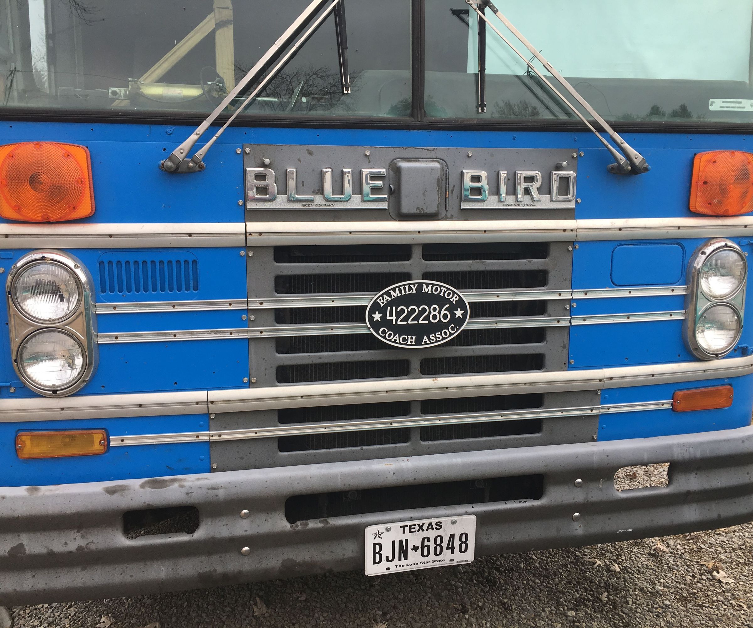

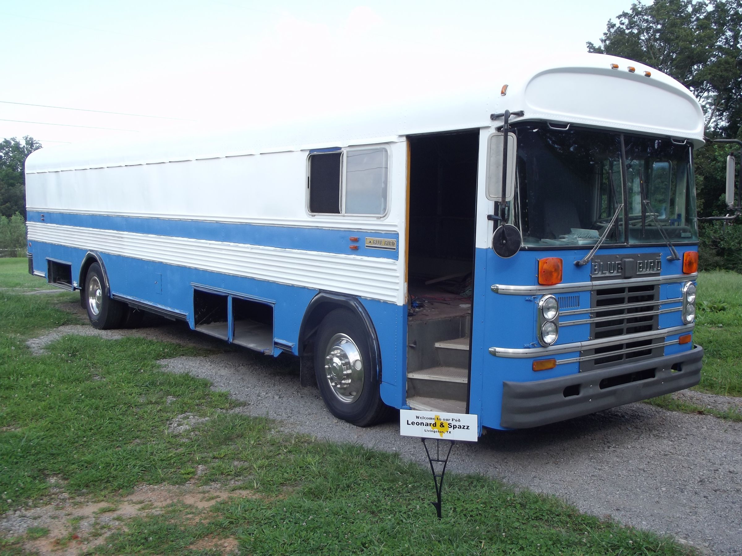

About: I am currently converting a 1988 40' Bluebird school bus into a motor-home / workshop that I plan to live, work and travel in. This is my second such project. This one will probably be my retirement home. Stic…
A great song writer, named Lionel Richie, wrote and sang a song called "EASY". That was the inspiration behind the name I've finally decided on for my bus. The first line of the song is, " That's why I'm easy, like a Sunday morning".
Part of the plan for the bus I'm building is to have a workshop in the rear of the bus. One of the things I will do in the workshop is make signs. I got started with this idea by wanting to do the graphics on the bus myself. I purchased a sign making machine and a new hobby was launched. I will be promoting my hobby on my website RovingSignShop.com and my blog RovingSignShop.blogspot.com. They are both under construction and probably will be until I get completely set up in the bus but I am able to make signs and graphics by request for anyone that may want something in the mean time.

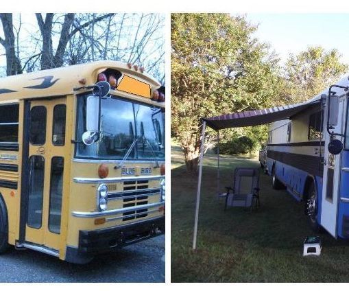

Don't forget, I'm far from finish my school bus conversion. More to come. Check back often or signup to follow me. You can follow my entire school bus conversion and my travels at leonardsteward.com.
