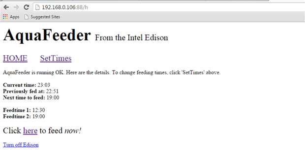

WiFi and Webpage:
Using your browser (like Google Chrome or Safari), you can access AquaFeeder through a webpage. On this webpage, you can view details, such as the time to feed the fish next, the time previously fed etc. You can also set custom feeding times or tell AquaFeeder to feed the fish right now.

  • Control AquaFeeder from any device, anywhere! - You can view details and set feeding times for AquaFeeder through a webpage on the local WiFi network!

Testing Edison's webpage:
Now, on your computer, type in :88/h. For example if the Edison's IP address is 192.168.1.12, type in 192.168.1.12:88/h. Look at the Serial port now. You should see the message "GOT CLIENT!" and some other messages after that. On your browser, you should see a webpage load that looks like this:
