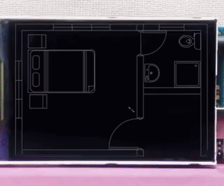

Step 4: Displaying Text and Shapes on Arduino 2.4 LCD
For more information on code and functions please check Basic TFT LCD Commands.
Step 5:
To display pictures on this LCD you should save the picture in 24bit BMP colored format and size of 240*320. Then move them to SD card and put the SD card in the LCD shield. we use the following function to display pictures. This function has 3 arguments; the first one stands for the pictures name, and the second and third arguments are for length and width coordinates of the top left corner of the picture.
bmpdraw(“filename.bmp”,x,y);

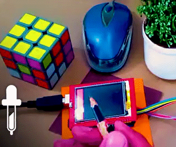

Step 6: Create a Paint App W/ Arduino 2.4 Touchscreen
