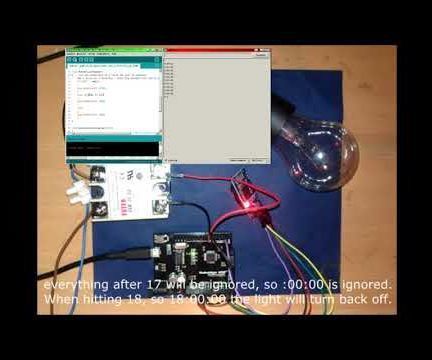

Hello world! Today i made a Example Code for the 4x5 matrix keypad.
I could not find any codes that were working or doing anything at all. So i made this example code for the 4x5 keypad.
You can let the buttons do anything! I just gave each button a function in the code, You can see what value is what key in the serial monitor.

Step 1: Schematic, Code & Parts List.
Parts list:
  • Arduino Mega! ( You need a mega!, Or you need to multiplex!)
  • 10x Leds.
  • 1x Buzzer.
  • Keypad 4x5 Matrix Keypad (very cheap on aliexpress)
  • 2x 1 channel relay
  • Jumper wires set MM/FF/MF
Just wire it up like the schematic. Here is little more info i grabbed from the internet about the 4x5 Keypad.
Connect:
  • Row 1 to Arduino pin 2
  • Row 2 to Arduino pin 3
  • Row 3 to Arduino pin 4
  • Row 4 to Arduino pin 5
  • Row 5 to Arduino pin 6
  • Column A to Arduino pin 8
  • Column B to Arduino pin 9
  • Column C to Arduino pin 10
  • Column D to Arduino pin 11
Key values with connector at top.
  • 4 9 14 19
  • 3 8 13 18
  • 2 7 12 17
  • 1 6 11 16
  • 0 5 10 15
Connector (from left to right with keys facing up, connector at top):
Columns Rows
X X X X X X X X X
A B C D 1 2 3 4 5
(Rows link keys from left to right, columns link keys from top to bottom)
Good luck!
