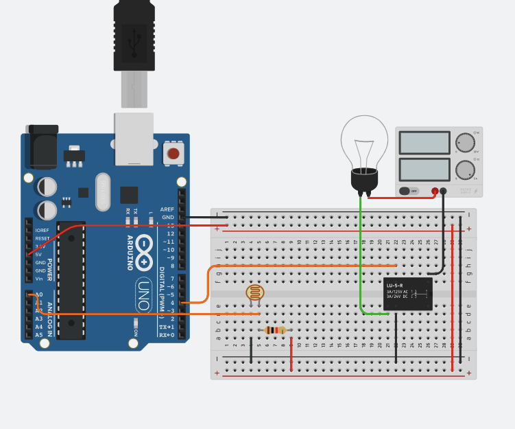

Step 4: Basic Assembly
Put down all the compoents that will be used. The bread board, Arduino, photo resistor, rgb led, led, switch, piezo. Make sure they are all spread apart so you don't run into issues.
Step 5: Resistor Assembly
First power and ground each of your rails. Then connect a 1k ohm resistor to any leg of the photoresistor and to the power rail. Another 1k ohm resistor to the positive leg of the buzzer. Connect a 330 ohm resistor to the red leg of the RGB led and two 220 ohm resistors to the blue and green legs avoiding the cathode. Finally connect a 1k ohm resistor to the anode leg of the LED, note don't connect it to any rail as it will be connect to the Arduino.
Step 6: Wiring Assembly
Ground the photo resistor and connect the other leg to the A0 pin on the Arduino. Connect the ultrasonic sensor to the power and ground pings. The trig and echo pings go to pin 7 and 6 respectively. Ground the piezo and connect it's resistor to pin 5. For the RGB led connect the cathode to the ground. Then connect the red, blue and green resistor to pin 11,10 and 9 respectively. Connect the terminal 1 and 2 legs of the switch into power and ground, then connect it's common leg to pin 0. Finally connect the final LED pin to 1.

This part sets each pin to output or input. The only input ones are the switch as we need to read its state and the photoresistor (A0) as we need to read the brightness.
