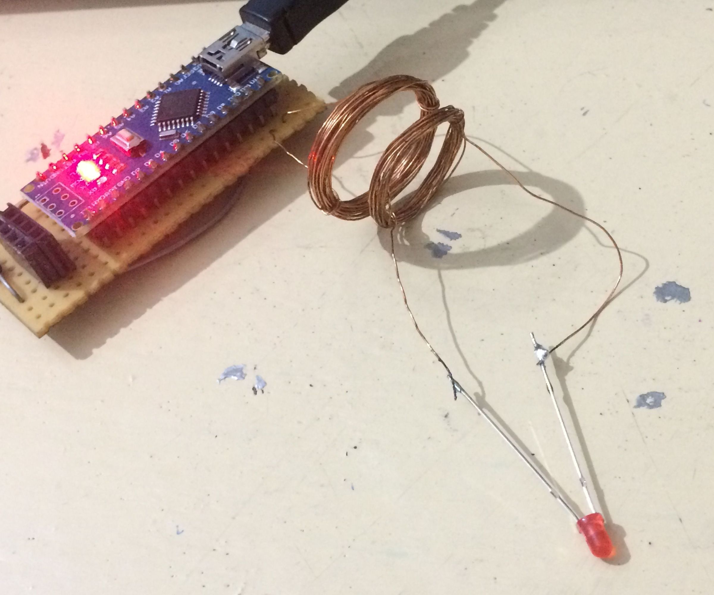

Step 3: Building the Converter
Make this circuit on a zero PCB. First we solder the mosfets, inductor, capacitors etc. then make links between them. also solder female burge pin header for arduino nano and current sensor. make voltage divider and connect them to input, output and arduino. give power to arduino by connecting vin on arduino to Vin on Ckt. also don't forget to make all the grounds common. I have here used to output capacitors to reduce the ERS. connect load resistor to output terminals. Connect the Arduino pins as Following.
A0 to output of ACS712, A1 to Vin_sense, A2 to Vout_sense. D5 to Boost_pwm of Tr2 and D6 to Buck_pwm of Tr1.
I,m giving input by Serial port. you can connect buttons to enter the voltage and currents.

Step 5: Testing
As your Circuit is ready it,s the time to test it. plugin a 9v battery to input and enter the voltage you want at output and watch it working. adjust the sensor offset values to get the precise voltage sensing.
