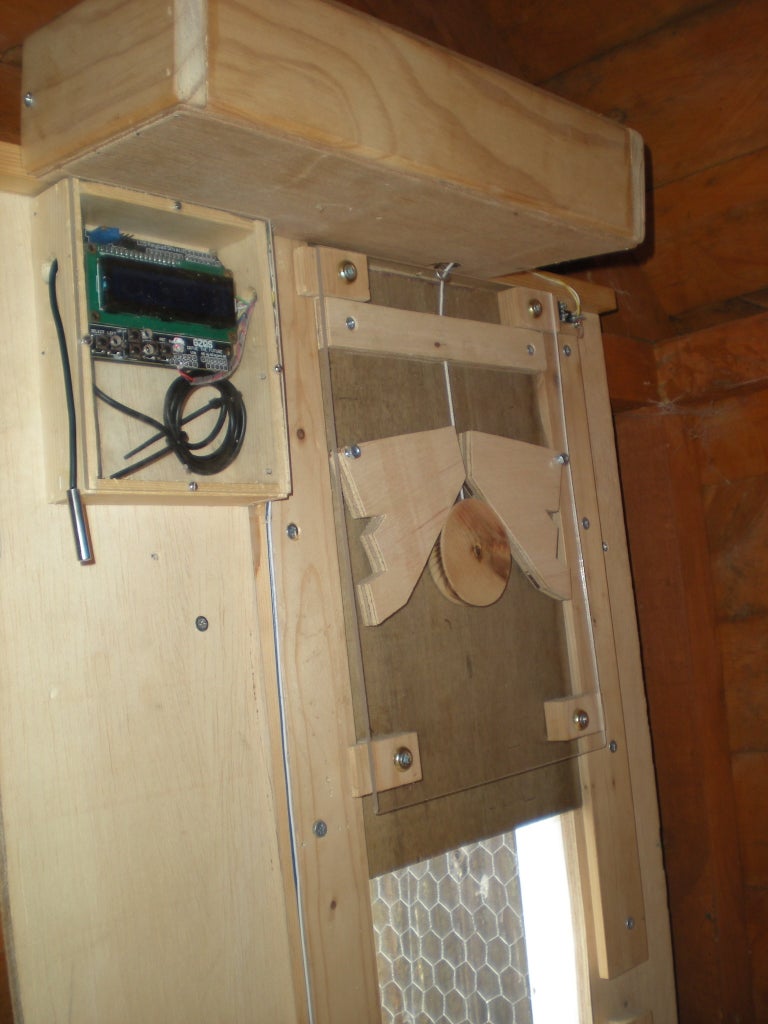

STEP 1: Building the Door

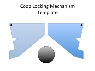

The door is based around a design by Clint Fisher which I discovered on YouTube.  This is a brilliant design as it actually locks in your precious darlings regardless how scrupulous the local fox or other vermin are in trying to prise open the door.   You could use a simpler design of just a sliding up and down sheet of ply.  It is up to you on how complicated you want the door - just don't make it out of solid steel as the motor will struggle to lift it.
Clint  didn't actually provide the plans on his YouTube link so I set about to recreate them and I have attached a PDF file which you can scale to your needs.  I hope from the series of pictures and my video file you can see how the door assembles and works.
Some pointers:
  • I would advise using the acrylic sheet facing plate rather than plywood as it provides a frictionless face for the pieces to move freely
  • You really need to see it moving to make sure it works freely and you know where to make any tweaks
  • It really looks cool and you should show off your handy work
Most of the pieces can be cut from 3/8" (10mm) ply using standard tools such as cooping saw, jig saw or a small band saw if you are fortunate to have one.  I have included the plans and templates.  If you print them on A4 paper the door levers and round are to scale.  You can always use a PC print driver scaling function to make sure they come out as the correct size.
Use brass screws/stainless steel bolts where possible and treat the ply with a suitable wood preserve - I wouldn't use a vanish as this might over time cause the workings to foul.  When fixing the perspex cover use brass screw cups to spread the load and will hopefully stop the cover from shattering.
I found loosely fitting the door lock levers ensured they worked even if they were damp from the outside weather.  I made two doors to test.  One has been in manual use to see how it would stand the damp and cold english weather - which it did!  So hats off to you Clint it is a very practical design.
I have taken loads of pictures so you can see from all angles the design and how it is constructed and assembled.  I haven't commented on every picture as I think it is reasonably self explanatory - well I hope!
STEP 2: Motor Assembly
I have seen many people do some extraordinary things with electric drills and screw drivers as kinetic power sources and wondered if I could go one step further to make them less bulky when incorporating them into the door assembly.
I wanted to source a motor and gear assembly that was under £10-15 which isn't easy.  I came across a cheap electric screw driver for less than £6 and when I stripped it discovered I had all the components I needed.  Including a:
  • 3.5v-4.5v Motor which could be hot wired to a chunky 6v battery
  • planetary plastic gear box which was going to provide enough torc to raise the plywood door
  • chuck and screw driver bit to attached a wooden real pulling the door opening cord
  • rechargeable battery pack to test the door assembly
  • plug transformer to trickle charge the motor battery - eventually substituted it for a 9 volt plug PSU so I could trickle charge the 6 volt lead acid battery and the 5 volt arduino regulator.
I am sure most DIY stores have similar ranges of value priced tools that make great sources for strong, robust and cheap motor assemblies.
I mounted my motor on some formed wooden support pieces and left plenty of space for the motor controller and regulators.  I housed the motor assembly so no moving parts would be pecked by my feathered friends - my coop isn't a tall shed.  The pulley is an old wooden cotton real but any real would suffice - make sure you can drill a hole through it for the chord.  As the real would only be moving for a few seconds up and down I didn't go overboard on bearings and tried to keep things simple.
I attached the real to the motor via a screw bit and some very strong double bubble glue- it goes rock hard when cured.

STEP 8: Installing Into the Coop
I was fortunate enough to design the coop opening to take this size door and to provider two uprights to give a strong fixing see diagrams below.
Make sure the battery is nicely tucked away from the reach of the hens and the 9V input cable is securely attached to the door which is behind the motor housing.
I would reset the door and check the time is correct and the right sunset and sunrise minutes are displayed for that month.  At the time  of taking the photo's we were in March which meant the time section would display:

As for Robot-Chicken, I really appreciate the detailed sketches of the latching mechanism.

I've automated our coop as well using a Raspberry Pi. The system controls heat, a/c, open and close of the door, turns interior light off and on, video camera inside just for fun mostly, and texts/emails me when door opens and closes, controls auto feeder and keeps my wife and I happy!
The biggest suggestion I can make to you is to use an electric linear actuator to open and close the door. This precludes the need for any locking mechanism. This is the 16" actuator I use: http://pages.ebay.com/link/?nav=item.view&id=361075336287&alt=web
Following up...3 years later...We started with 12 peeps, sold 4, 4 gone to predation (the risk of letting them run free). Arduino based Uno R3 running continuously all 3 years!
Now returned to door design for the next batch next spring. I modified some code from Roger Reed. My controller takes care of lighting, power ventilation in summer, shared with water heater for winter. (inverted flower pot with light inside). RTC will remain as a system clock. It also has a separate egg box light that flashes should the egg box be left open. One indoor temp sensor (no display :( (yet!)), but still actively in control!
Hope to add 2 more temp sensors and an indoor remote controller over rf this year...parts here, time not. The implementation of all features desired will require a mega 2560, and I am considering off loading door control to a subsystem for modularity. Light is currently relay controlled AC CFL, and will be replaced with LED pwm, filtered to remove flicker, and fading up/down to improv asthetics for the girls. Door will have a servo lock as I did not like the mechanical solution for the added weight. Locking will be verified by status LED, as will door position.
An addition I really like (for anyone considering a smlilar project) is an LED flashing a heartbeat. It is visible from the house, dims at night based on a light sensor, and provides reassurance that all is well, without being over bearing at night. It provided great feedback during the -20F temps last winter to know the system was surving and operating normally! (I was delighted the UNO clone kept on chugging through the 2+ weeks of sub 0 temps!)
