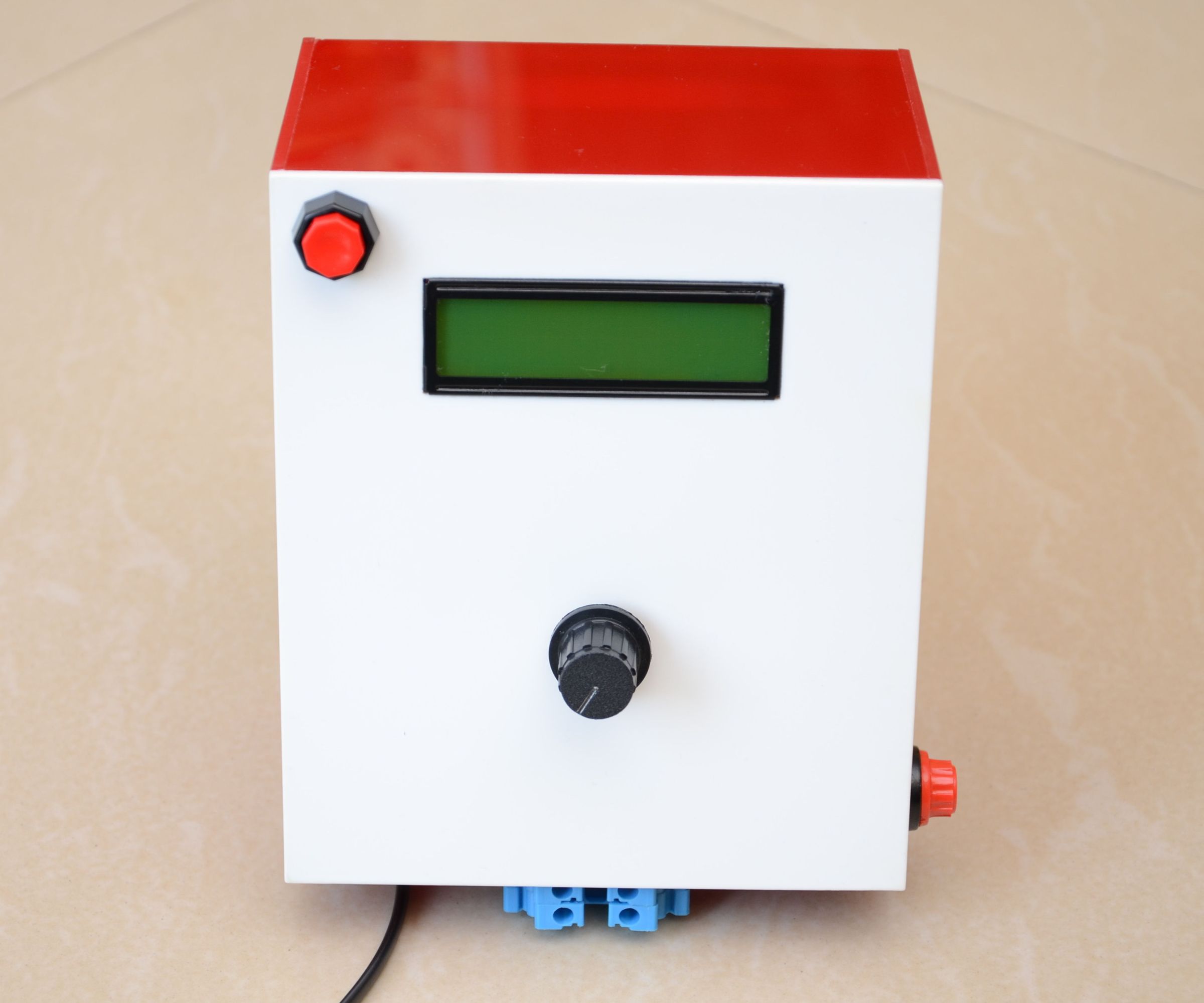

This is a nice and simple versatile on/off timer built around atmel microcontroller Atmega 328 chip.
As the name suggests, it is very versatile timer with N number of applications you can think of.

Once the system is on and programmed and started.. it continuously shows the time remaining (in seconds) in current mode, updated every second.
Max Delay : 12 Hours
Min Delay : 1 second
The timer operates in 3 modes
1) INITIAL -- This is the time for which the relay will be in ON state when you run the timer first time.
2) OFF -- This is the time for which the relay will be in OFF state.
3) ON -- This is the time for which the relay will be in ON state
so the relay always cycles as following sequence
INITIAL --> OFF --> ON --> OFF --> ON --> OFF --> ON --> . . . . . Indefinitely

After uploading the program into the microcontroller, take out the IC and put it into the IC base of the PCB shown aside. Fit the LCD using the break away header pins as shown in the photo. Notice the angle in which pins are bent for the proper fitting of LCD board over the one we made.
Assemble the complete circuit and test it by powering it ON.
Step 5: Fitting LCD in Case
The photos aside shows.. how to fit the LCD in front panel of the box.
I recommend to not to glue it to the box.
The rectangular slot cut in the wooden sheet should be so perfect that the LCD fits very tightly in it.

Step 8: Ready to Go...
The wooden box is finally brushed thoroughly using a very fine sand paper and then coated with clear varnish spray to give it a good look.
Now the device ready for the operation...
