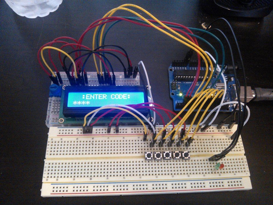

Step 5: Wiring It Up - 16x2 LCD Display!
This one is a little more complicated, but not by much.
The link in Step 2 directs you to Lady Ada's tutorial on LCD Displays. There she covers the wiring and code to get your LCD up and running! For this project, we will be using Digital Pins 5, 6, 7, 9, 10, and 11 of the Arduino. The picture shows the corresponding connections as there are 6 between the LCD and Arduino.
We will use the display to show the status of the sensors, and to show the time when the system is idle (no "intrusions" detected).

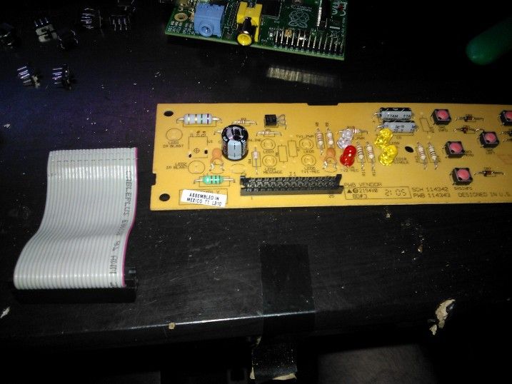

You also may realize that some of the materials listed I did not use. I left those out mainly because I cannot find the PCB I got specifically for this project, and my nearest Radio Shack is not very "near", so once I find it (or am in the neighborhood), I will amend this tutorial with the final result of the project!
